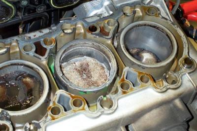

This is a pic of a sleeved motor. You can see the sleeve in the middle cylinder has been pulled down when it got caught by the piston rings, thereby causing the top of the piston to break off.
Need to see pictures of the sleeve to see if it really is sleeved. How many miles.
Yours was made just before the window period, but the period is a guess since Porsche has never acknowledged they took defective blocks and sleeved them.
Porsche has a list of the sleeved engines. If yours is sleeved I would raise heck with Porsche. The engine was not designed to be sleeved.
