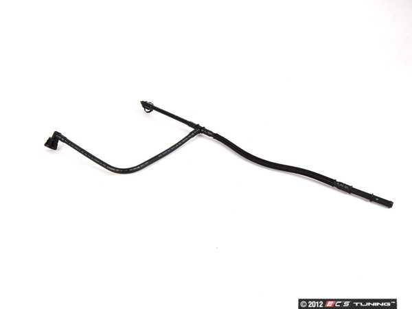

I have removed the manifold to install it again very carefully (with new gaskets). In addition to that I will check the other two points you mentioned as possible origin of the problem. The thin plastic tubes into the V of the engine is this coolant vent line (94810601693) Picture 1? And the small leak somewhere between both MAF and the manifold could be in this part (Picture 2)?

Also check under the Y air intake. It is very easy to get the vacuum connection under there to hit the fan.....

So as to see and hear on your movie, it can be only a small detail. It is not that one of the cylinders is missing or so, therefor the engine does not shake enough. Check all the specified items, including the theottle/manifold connection. If you cant see anything, use a PIWIS or similar diagnostic tool to find out whats wrong.
