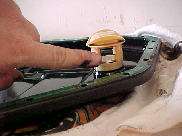

Yes, once you get the ATF up to temperature and not over 40 degrees C, you place the car in park and fill until the fluid overflows. The volume of ATF in the tranny is directly related to it's temperature.
There is a great ATF Replacement write-up HERE
The fill design ensures correct transmission fluid level provided the ATF it is at the right temperature.
