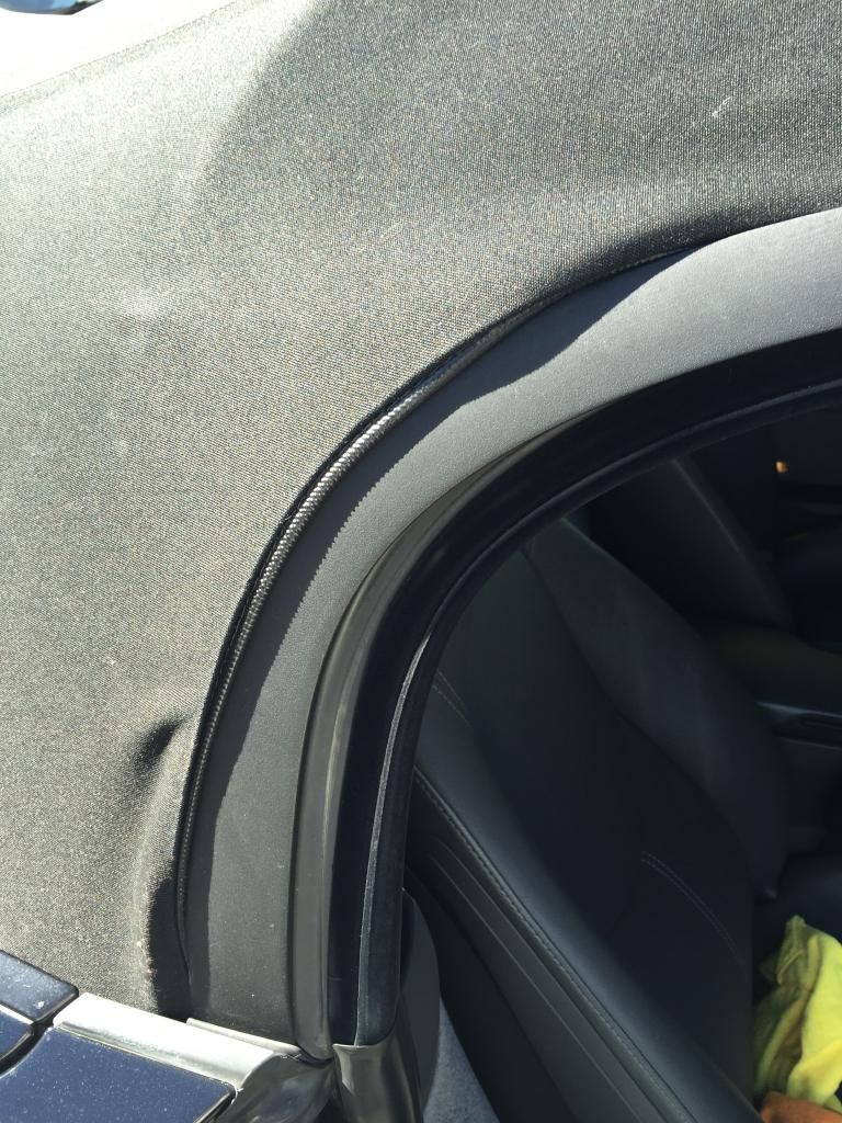

What do I need to do to fix this?
Thanks for the suggestion.
I finally got a chance to take a good look in there and as far as I can tell, everything is connected properly and nothing is broken, or visibly worn.
I compared the left side that functions properly, to the right side, where the cable ends up on the outside of the trim.  I can see no difference in how all of the cables, catches and elasticated bands are routed.
Any more suggestions from anyone?

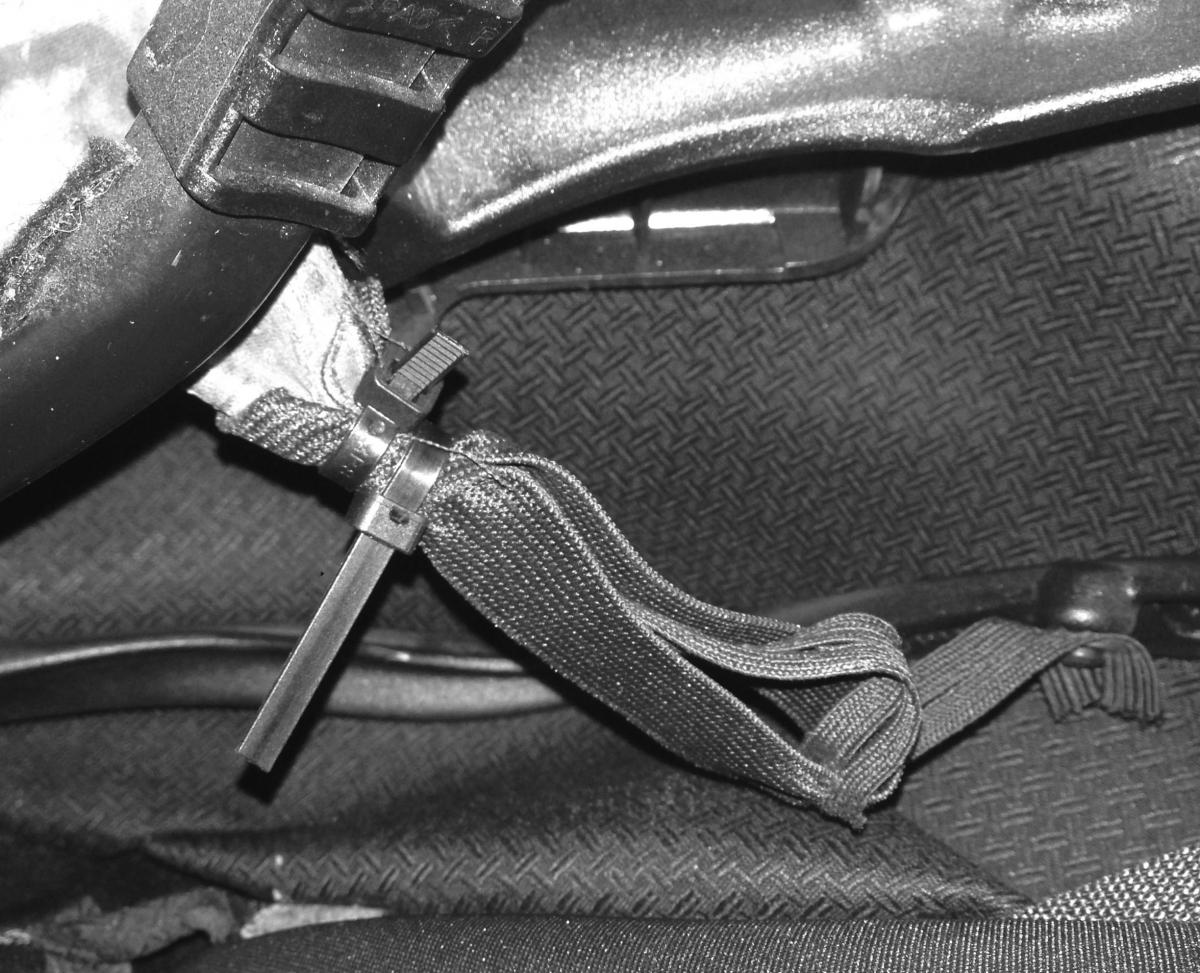

I finally got a chance to really examine the various straps and chords that ensure the top closes properly.  what I found is there is a very wide strap with some elastic screwed to a bar down on the bowels of the mechanism.  The elastic was not hardly elastic at all any more.
I fixed it by pinching the elastic (to make it shorter), then zip tied it to keep it there.
Voilà, the side wire now slides perfectly behind the trim,  :thumbup:

Hello everyone,
I am a complete newbee and have already benefited from this forum, particularly this topic; thanks so much.  I found the youtube video by Ray K which is very clear, but I modified it a little bit: instead of sewing, I fold back the end of the canvas to increase strength then use two medium zip-tie to secure the elastic band. Works perfectly on both sides now and should last a long time.
post-100107-0-45561800-1423467199_thumb.
Best,
Romeon
Sorry, the long tail from the zip-tie has been trim.
