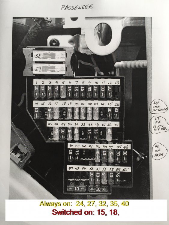

I posted information on both fuse panels with pictures in my install of a Blackvue 650GW dashcam.  If not here, then look in 6 speed.  Never mind.  Found them and attached. Notes on and at bottom of each picture.
