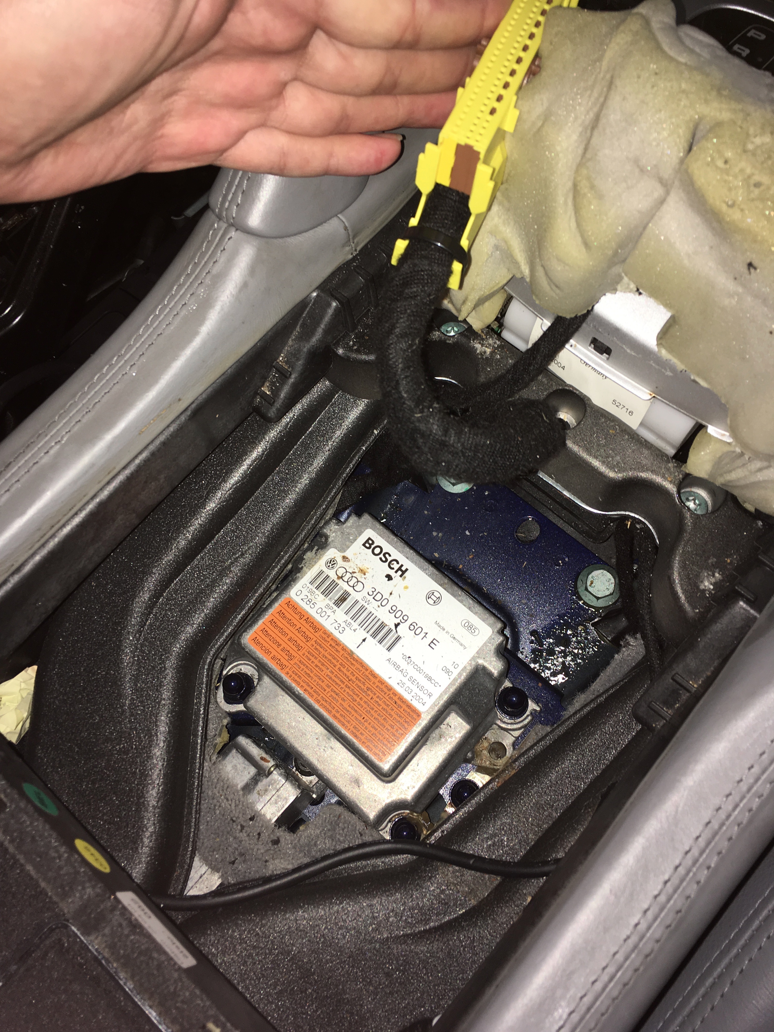

I don't know when they activate, but I head a dead airbag computer in my 955 when I bought it (someone spilled a beverage). It's right under the cupholders in the center console.
I think you could disconnect battery and unplug the connector from the airbag computer pretty easily. The box is super easy to get to, just just remove the screws holding the oddiments tray on, then the center console trim comes up, exposing the box.

OK guys, looks like the only safe way I can work out is to remove the module, whilst off road.  This involves disconnecting the battery, which means I need the radio code....going to put another thread up for that.  Will then report back.    Going to need a quick way to do this, if tis going to be a regular thing.  thinking of fitting a cut out switch to the battery.
OK - folks, I've done some research and checked my car in detail.  It looks like disconnecting the battery and removing this box above (or disconnecting it) is the way forward.  It looks like my PCM2.1 doesnt need a code so I should be able to disconnect battery without fear.  Further research indicated that actually there is a roll over activation built into the airbag system.  Hence the need to do this.
