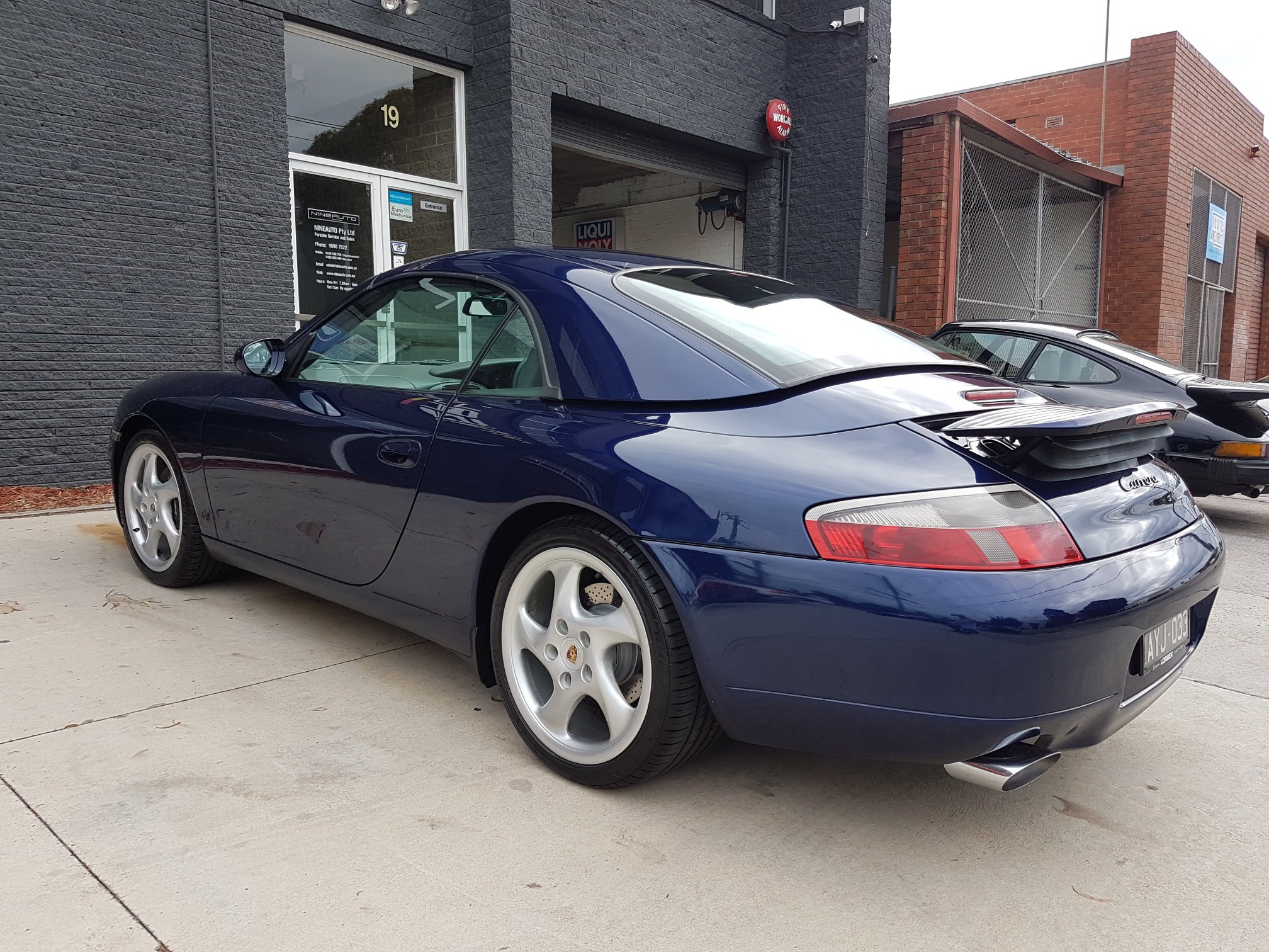

Hello, I am new here and this is my first post as I have just purchased my first Porsche (pic below)
I am really keen to get my son out with me for a drive in my 2000 C2 Cabrio and want to give him a ride this coming weekend.
