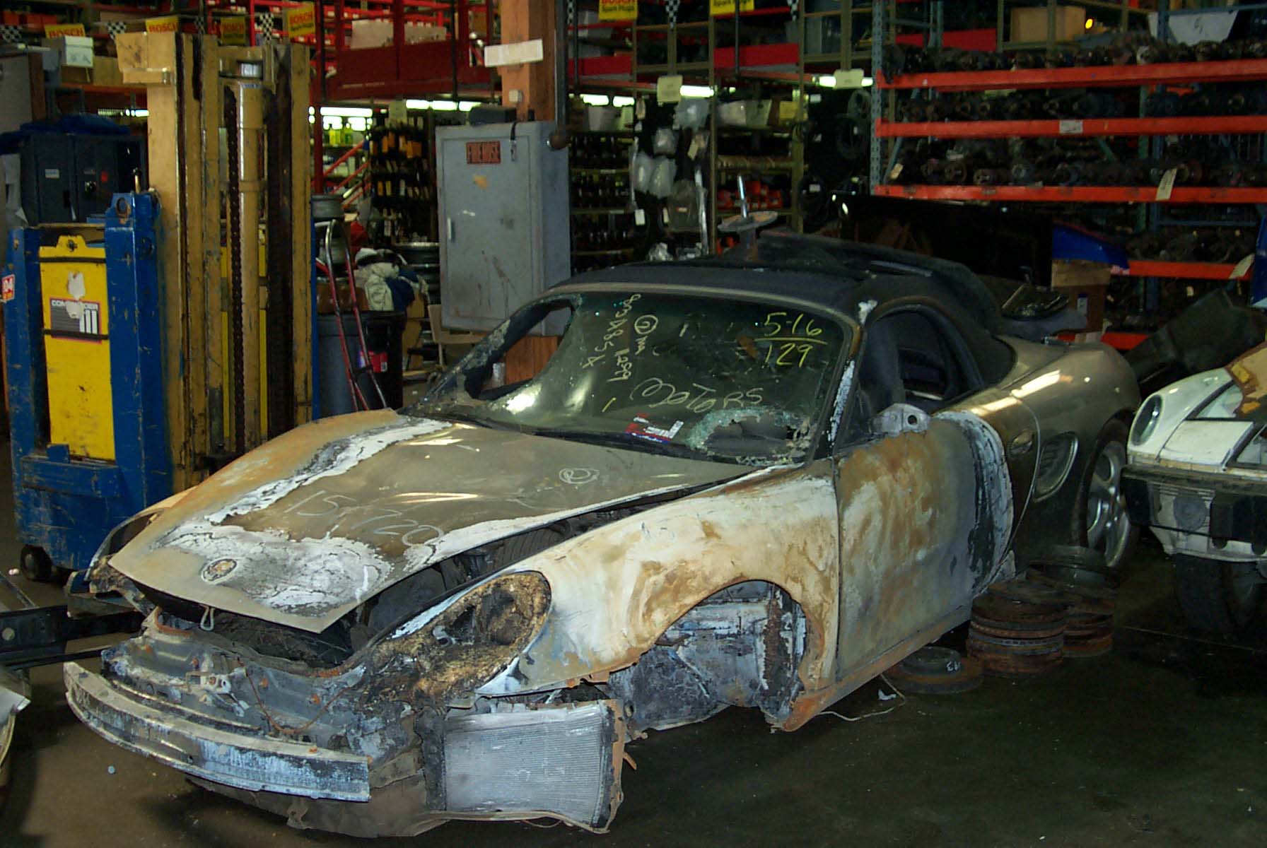

Yes, if you want the car to catch fire(!) :o
Fuses are rated to protect the cabling, as well as the end component. You'd be inviting disaster if you start uprating fuse values. But as Tool Pants said, you will be quite safe adding the equipment you have quoted.
