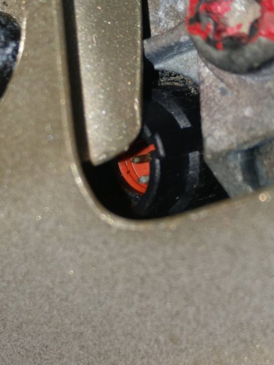

I got a used part for this to test. It fits perfectly to place but the camera cable plug is just in a wrong location and it is impossible to tighten it with camera in there. I would need to cut a piece to fit (see picture) If possible, I would not want to cut anything. Also the microswitch location is different on this version. (not that it matters but it is different)
So, I was wondering, is the Porsche version same as the Touareg version? Does anybody know?
Because this 3rd party camera handle https://car-solutions.com/en/tailgate-handle-camera-for-porsche-cayenne-volkswagen-touareg/ seems to have the same microswitch location as my original handle without camera, makes me think maybe camera cable goes from a different place also.
