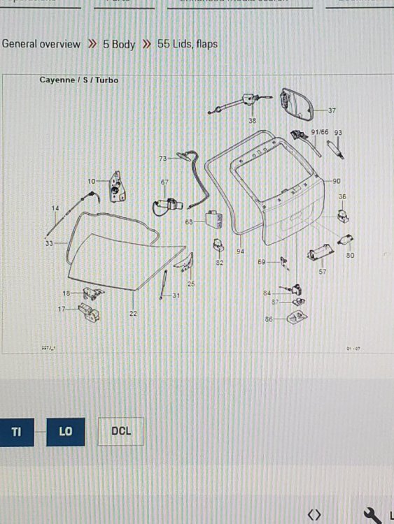

Having problem with my 957 rear lid/hatch. When I push the electronic close button, it closes but does not fully latch. (It will unlatch itself and opens up a little bit with beeping sound). I can physically push the lid and keep it latched, but because the second latch isn’t engaged, the car thinks the door is open.
I replaced #86 and #84 with brand new units, but the problem persists. I’m noticing that the #86 does not engage at all and stays retracted at all time regardless of what I do with the rear lid and its latch. Anybody had the same issue? What did you do to fix it? I’m open to ideas.
