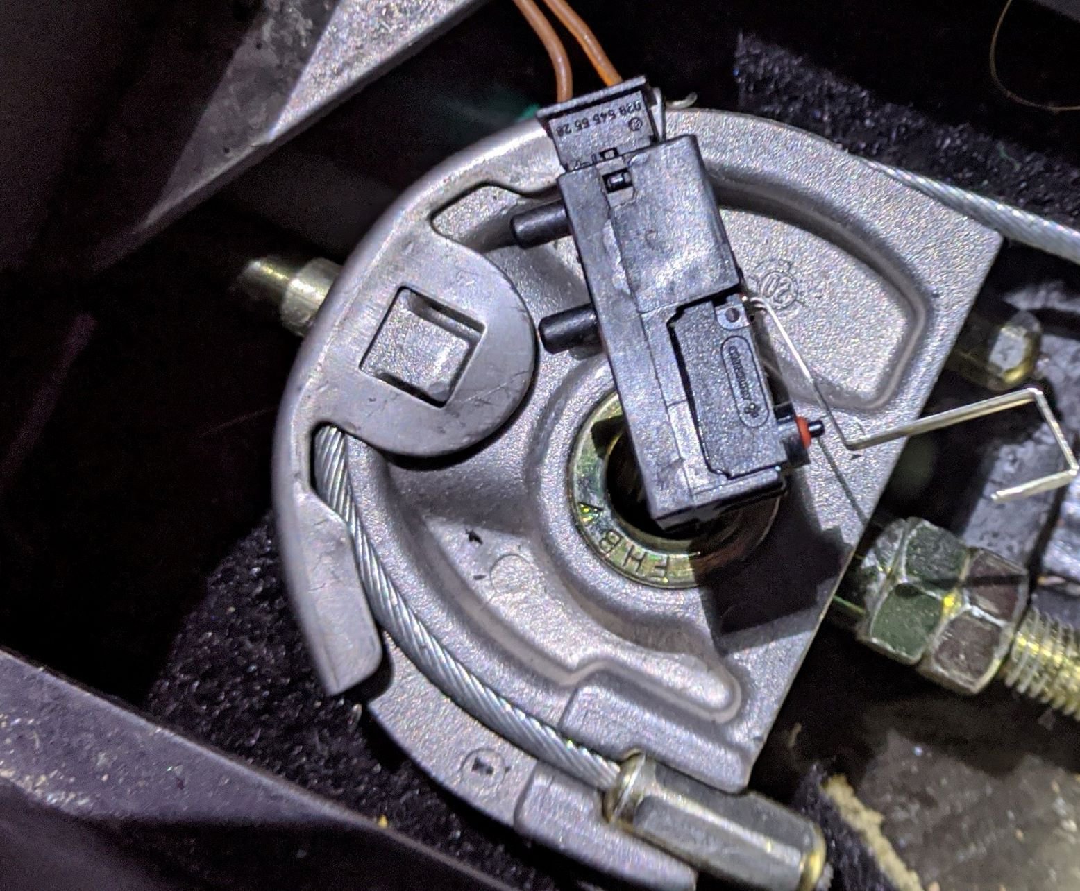

I recently took my council out and there is a micro switch laying next to the emergency brake lever does any one know what it is for?
There is a microswitch for the emergency brake lever.  If the brake lever is pulled up, it lights up on the gauge cluster.  If the brake lever is down, it does not light up the on gauge cluster.  Just a simple warning light the emergency brake is applied or not.
it is near the brake light switch but its not for the ebrake just laying near it
My guess would be it is for the center console lid.  It is monitored by the alarm system. Open and it makes the alarm system beep when locking.  Are you getting a beep when locking the car?
