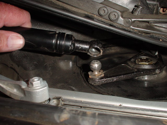

This time, my convertible is stuck in the up position, the right side flap doesn't want to raise so my top can come down.
The left side of the clam shell can open a gap up to 12 inches high, while the right side stays in the normal down position. I didn't try opening any further for fear of breaking the clameshell thing.
I briefly looked under the clam shell, there is an arm (looks like a 'V' or 'Y' or a seesaw" which is at a 30 degree (from horizontal) angle on the left side of the car, and the one on the right side is still at 0 deg horizontal. So it would seem like the motor for the right side is broken. (I believe the motor drives this 'Y' piece to rotate, but i'm not sure.).
Another diagnosis, when operating the switch, sounds like motor sounds from both left and right sides...which indicates the transmission/motor for both sides are still working.

As I mentioned earlier, the V itself is not turning on the right side, which leads me to believe the right side motor is broken.

There is only one motor that does both sides. If you peer into your partially open clamshell, its right in the middle (just forward of the brake light) and has a bowden cable coming out of each end - one for the left side and one for the right. Keep searching in the 'Boxster Top Issues' subforum because you will be able to remove the cable and spin the inner to releive the pressure on the right side.

it took a long time to try to remove the black rod on the stuck side (about an hour?!?!)
We eventually got in from the inside, used pliers, and yanked the clip off.
In the process we also took off the broken cable (the cable connection to the motor had snapped off).
Yes I have the upgraded cables in my 2000 S. The cable is "stranded" rather than "solid", which Mark remarked as being the first time he has ever seen that.
We were able to put a drill to the cable and spin it just a lil bit.
Another note, on 2000 and above, there is a plastic covering which extends further down than pre-2000 models which makes it VERY difficult to get any leverage on the black rod when trying to pop it out.
