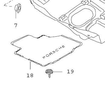

My carpet mats keep moving around on me. I noticed they have what looks like circles of the loop part of velcro on the bottom but there is nothing on the floor for it to hook on. I since found the following picture in an earlier post.
If these are real Porsche items do they have a P/N? Where can I get them or something else to keep my carpet in place?

My '05 987 came with a small box containing the four plastic fasteners shown in the above photo along with an installation diagram. You just invert the plates so that the screw is facing down and twist them into the carpet (two on each side) on the floor just in front of the seats. I don't have a P/N but bet you can easily get a set from your dealer.
