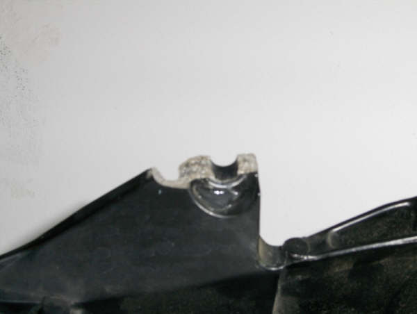

hi, unfortunately its not the push rod.... i replaced that last month because it broke... the new one was the one with the white top... the reason why the first one broke was because the metal ball that it attaches to fell off because the bolt on the back came lose... this time the piece that holds the metal ball broke off... check the white push rod and for some reason its still intact... i need to find out the part that the metal ball screwed into because that's the part that broke....help please...

yes jeff, unfortunately the mounting lug has broken off the frame..... it was okay when mark and i checked it out at the work on cars day... but just two days ago the lug broke off... so i guess i need a new part but can't find the part number... i don't know if the part can be welded back... do you possibly know what type of material is used in this part of the car... funny thing is that the top can still go up and down with the switch...

That is not good. This is why, when I saw the male ball in Mark's hand, I asked him to check to see if the mounting lug had broken off, because that is something that could not fix at Henry's house.
Next time I'm at the dealer I'll ask the mechanics I know what kind of fixes are available, but I already think I know what they will say.
I have never removed the complete top/frame from the car, but the mechanics have. They say it is just removing a few bolts on each side, disconnect the push rods, then lift it out of the car. If you have the broken piece and if it can be welded back on, then that will be a first to me.

yeah when mark and checked it, it was okay that's why we were able to reattach the ball....don't know if using a larger bolt and possibly it being too tight could have caused the break...it's on the driver side....

I spoke to and went to see a friend of mine who works in the parts department of a local Porsche dealer here in NY and this is what we were able to come up after also talking to the techs at that dealer:
It looks like the part is one component of the "Main Folding Top Bow" and has a part number of 986 561 037 0070C and that it sells for over $2,000. I checked with Sunset, and their price is $1,594.56. The smaller part (where your steel ball broke off a little "ear") does not have a separate part number that we could locate on the system. OUCH!!!
I asked my friend to let me know if they get a top in that they have to remove as I would like to have a look at that individual part directly and see if it has a part number that can be looked up.
Sorry I don't have better news.
