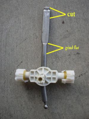

This is a picture from 2 years ago of what I thought 986 owners should do to duplicate the 550 special edition "short shift.". But you cannot remove the shift lever like in this picture for the modification or you will not be able to put it back into the shift tower.

So the shifter I have to take out the whole assemply (with tower) to cut and shape it?
