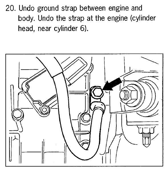

I finally believe after all these months thanks to members here,I have found the problem to my starting issues, a faulty ground strap ! Does someone have a photo or can tell me where this is located on my 2002 911/996 ? I live 200 yards from the ocean and everything rusts here, and I believe it's a bad contact, can someone advise ? Dave
If the wire is brittle, stiff, old and crusty I recommend replacing it. Also clean up the mating surfaces on body and engine with a wire brush, then after reinstalling smear/spray on some protective coating/grease designed for electrics.
  • 4 months later...
You can reach both ends by jacking up the Right Rear corner and removing the wheel. Piece of cake if the bolts aren't rusted on like mine were! :D
