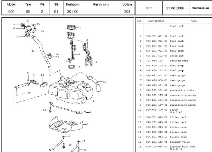

Your best try would be to put a magnet down the fill
tube. Then I would take the float and pump out and try
the magnet again. Last would be removing the tank and turning it
upside down. I have enclosed a 996 picture of the tank.
Paul
There are some "marbles" inside the tank to reach the exact quantity of fuel as stated in the manual (the capacity of the fuel tanks are higher than stated, Porsche put some "marbles" in the tank to compensate this.)
Hi Everyone.
Well I finally got the time to take the other plastic cover off.. under there is the fuel tank as you all know and can see from the picture above (thanks for posting that) it is the float thats making the noise or at least something inside the float.. The noise does seam to be less when the tank is full getting worse when hitting a 1/4 tank or under.
