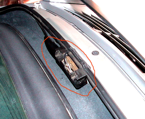

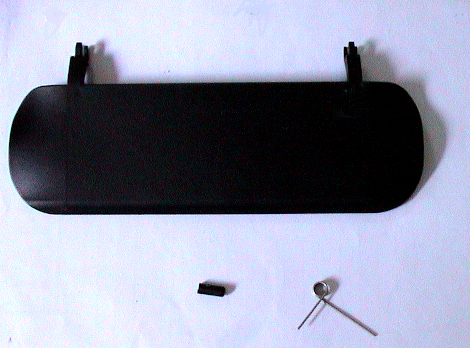

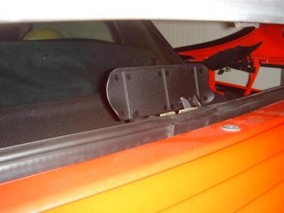

When I lowered my top yesterday I heard a somthing pop and the top wouldn't go down all the way. I raised it to the service position and saw a plastic plate (about 8 imches by 2 1/2 inches) and spring next to the latching mechanism.
After analizing where it came from I deduced that it protects the canvas from the mechanism when the top is down. It seem that one of the platic tabs on the latching mechanism broke off. This means that the entire mechanism will need to repalced.
Has anyone had this happen? How is the plate supposed to be oriented? Can anyone give me a part number? Attached are pictures of the mechanism and the plate that covers it.

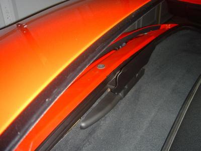

If anyone can photograph their Cab is the service position and show me how that piece is oriented I would appreciate it.
Thanks !!
Phillip

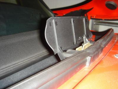

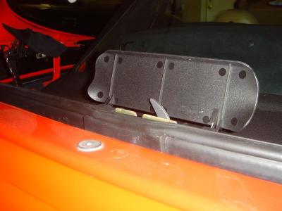

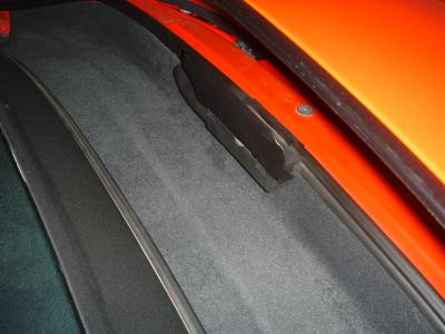

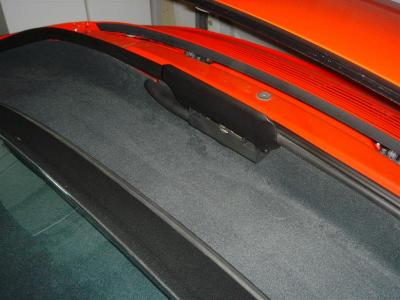

Yes, This part is to protect the top when the metal "hook" it latching. If you need to operate the top without this piece in place, you must lower the top and manually move it away from the latch before you continue - the metal latch will damage the top otherwise! I believe I paid under $30 from Sunset Imports. Here are some pics of it installed.
