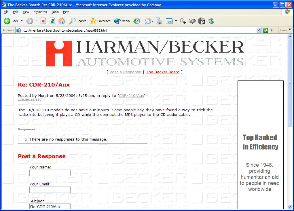

If you need an aux-in then this is one alternative.

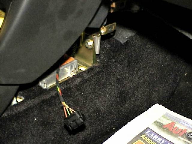

the connector may be velcro'ed down, or it could be flopping around loose. it should be the only loose wire bundle in the area. left/right, i don't know. there's not much space under there, so it should be easy to find.
the side carpet pieces that i'm talking about are the carpet pieces that surround the center console. when you say 'center console side panels' i think of the vinyl/leather pieces at about knee-level. you don't need to remove those. just remove the carpeted pieces behind (towards the front of the car) those pieces. you'll see.
the wire doesn't actually come off of the stereo. it's not connected to the stereo at all.
here's a pic:
bingo. got it.
the previous owner of my car had some issues with the shelfs of the center console. my lower one pulls right out and the 3 prong female connector was staring right at me on my 97.
i was hoping to get power with the stereo on off but the ignition switched will work fine for me.
