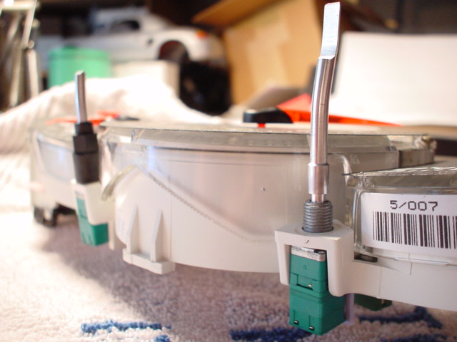

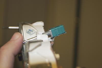

I have a 2002 996 Tip, with broken stem on the instrument cluster. I have taken the cluster apart following all the posts and pictures, and looking at the stem, as it is attached to the instrument ribbon, I cannot see how the broken stem can be removed and replaced with another stem from another cluster. Any help would be appreciated.

I was going to fix a 996 ebay cluster with a bent and a broken stem to use in my Boxster. But then I discovered the 996 cluster also had a bad middle LCD display.
By the way, the metal stem 996 clusters were 1999-2001. 2002 Porsche switched to plastic stems. So your pictures would not be of a 2002.
Are the plastic stems in the 2002 and newer 996 clusters also part of a switch that is soldered to a ribbon, if so, then there is a big difference between a Boxter cluster and a 996 cluster. The posts I have seen here, suggest that the stems are easily interchangeable, and that the hard part was finding a donor cluster. Is de-soldering the switch off the ribbon something that can be done at home?

On a cluster with plastic stems the stems are easy to swap, if you can find a stem from a donor that is not broken. The end of the stem fits into a switch, but the stem is not part of the switch like it is in a metal stem cluster. So, this is a different design then a metal stem cluster.
I did not try to remove the metal shaft switch from the board. As stated, my cluster turned out to also have a bad LCD display so there was no point in trying to replace the switch.
