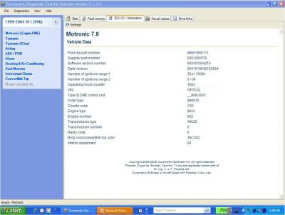

Looks good!
No over revs...
But looks babied - very few redlines....
BUT I have a question
why is there a difference between ignition ranges and operating hours? 1502 h vs 1583 h ?

Ignition range (1 in this case) is the last time an over rev was recorded...so essentially the last redline incursion occurred 81 hours ago.
Oh and I would erase/cover the VIN for security reasons...

Ignition range (1 in this case) is the last time an over rev was recorded...so essentially the last redline incursion occurred 81 hours into operation.

Well it is the better safe than sorry:
1. I could do a complete vehicle history on your car,
2. I could use that VIN on documents,
3. It could be used by car thiefs...
just too much information available...

ok fixed :-)
