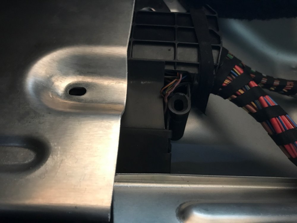

My problem can be marked Solved I'm not sure if the problem was self inflected since i was just recently in the same area (other side) but looking at the pictures of the relay/DME area of the rear deck on the relay side the chamber that houses all the wires had a few stray wires that where not in the chamber and where squished against the large aluminum panel of the relay circuits. I have a heavy subwoofer that sets on top of this area so I think the weight combined with the heat (over 100 degrees here lately) along with engine/subwoofer vibrations wore away the insulation and shorted against the aluminum panel (ground). The wire being shorted was from the "high/low pressure 3 level cooling water switch" (pin 1). This sources 12v to the air conditioner compressor relay (pin 3, violet/yellow) whenever the ignition is on and cooling water switch is in it's normal closed position. This can all be found in the area of L49 of the wiring diagrams. I insulated the wire, made sure they are all in the wire harness, then remounted the relay panel. Short removed, air conditioner and heater fan are both working properly again.

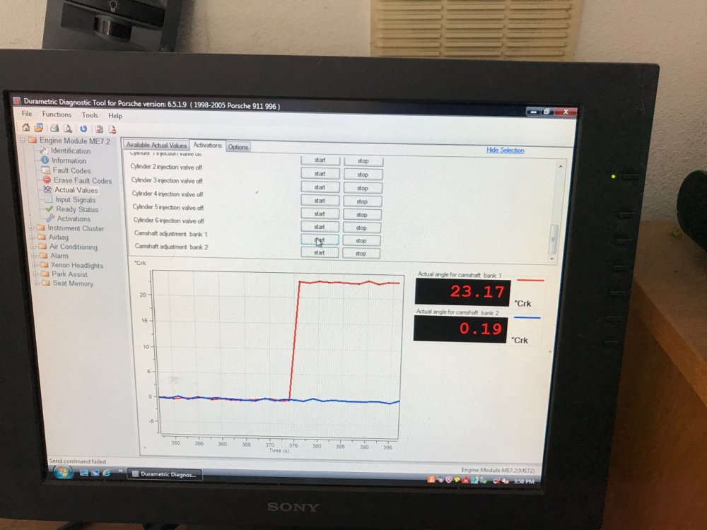

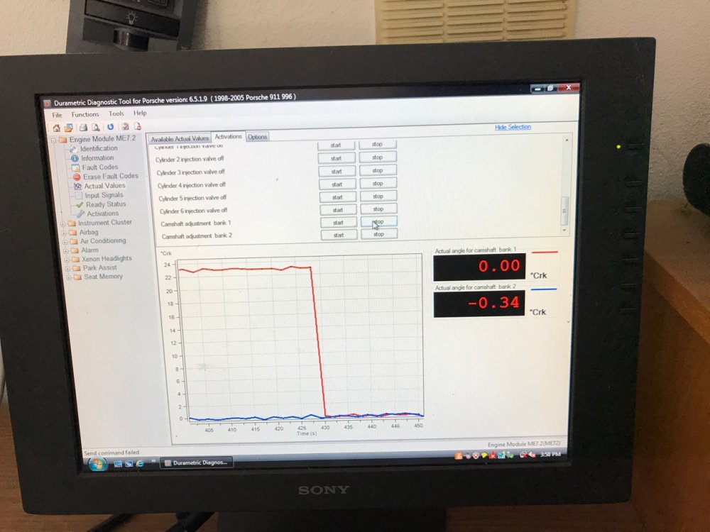

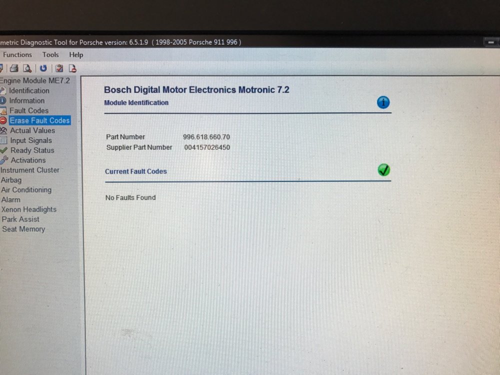

At the smog test facility (DEQ), all systems had become ready except the secondary air (after logging about 50 miles in all different conditions). I don't know about other states but in this state you can have up to 1 test device "not ready" and still pass. Its been very hot here in the northwest the past week with temperatures over 100 degrees. Combine this with some aggressive driving and stop and go traffic. So far there are no leaks spotted. Everything looks sounds and drives great. Engine pulls strong, no misfires. I ran a quick Durametric test again today (see pictures). It still reports no errors. Engine cam timing is identical to before. I can now preform the "camshaft adjustment" on bank 1 and/or bank 2 from the program.

Quick update durametric shows variocam advance on both banks just as expected. Pictures later but wanted to announce the great news...

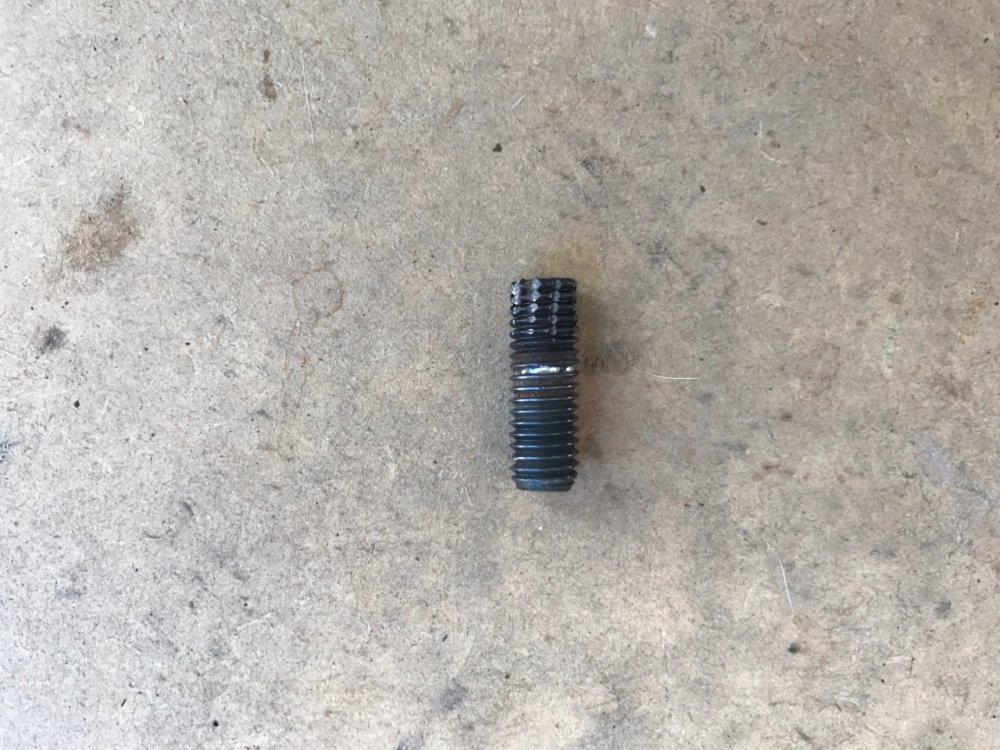

I'm going to call today two steps forward, one step back... More progress getting it all back together. Just about all the new parts are in (motor mounts, magnetic oil plug, serpentine belt, plugs, plug tubes, cam caps, etc. Oil pump is in, oil pressure sensor is reconnected, new solenoid is connected, big ground wire is reconnected, air conditioner compressor is back in place, aux air pump is back in and connected. airbox is back and MAF is connected. Ignition coils are reinstalled and connected. Heat shield and muffler support is back in place. The only parts remaining are the exhaust manifold, the muffler, the heat shield and the bumper, Oh, I need to get oil inside... I borrowed a tool form my friends friends machine shop. He said I could keep it but I'd hoped I wouldn't be needing it for a while after this job is complete. I'd seen this tool before and was excited to have it to use on those two twisted off head bolts of the exhaust manifold. The great news is it clamped down nicely and with a little work twisted out the first stud. The not so great news, The last stud at the end of cylinder 6 was not as friendly. it's like the bolds are made of mush... it twisted right off smooth with the head... This is what I'm left to deal with... drill and easy out or ???

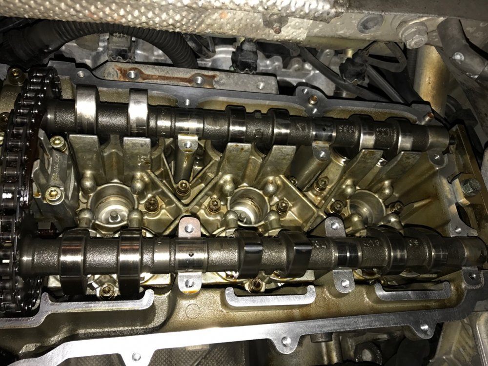

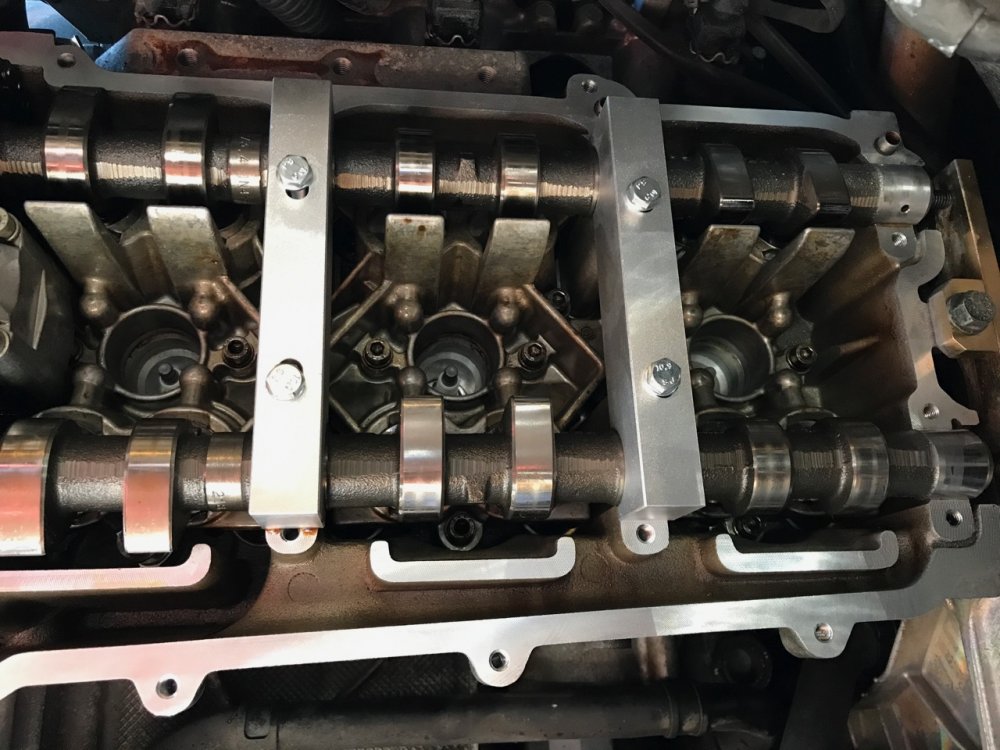

Update The reason the cover was so easy to remove is the cam was 180 degrees from where it should have been. This caused the exhaust valve on cylinder 6 and intake valve on cylinder 5 to be open, creating pressure on the cam, transferring to the cover and aiding in breaking the seal to remove the cover. The bad news is there is now a problem getting the cover back on. The same pressure pushing on the cam is causing the cover to rock when trying to put it back in place. After a few PMs with experts the solution we're going with is to oil up and installing the saddles to push the cams in there correct positions then rotating the engine to a position where there is no pressure on the valves on that side of the engine. The other TDC would be the ideal but this is where I have questions. In order to get to the other TDC, both cams will have to move 180 degrees meaning at least half the lobes will have to travel though there highest pressure positions. Looking at the current position would it make more sense to just release the pressure on cylinder 5 intake and 6 exhaust? that would only require 90 degree change of the cams (180 of the crank). This accomplishes the same without un-needed rotation using the saddles (i'm not confident they are designed to allow the cam to actually move freely, I don't want to create anymore damage (if an at all) then necessary). Saddles are in place with lots of oil where they come in contact with the cam, The cam hold down at the back end of the cams are in place, screws are engaged into cam but are free to turn. I turned crank slowly watching the tension on chains. it looks like its moving freely. I turned the crank about 180 degrees, everything seems to be moving together without resistance. No lobes are touching now. Is this far enough or is there a reason to go al the way back to TDC? If i have to go to TDC, thats going to force cylinder 4 exhaust and cylinder 6 intake to go through there highest stress points. I don't want to do this unless there is good reason. I'm confident the timing has not changed as everything moved together and the intake cam is now pointing at 6 o'clock it was at 3 o'clock and the engine is at 180 from TDC, just where i'd expect. If it's important to go to TDC I will keep going, I just want to understand why. Please advise, and thank again for all the help.
