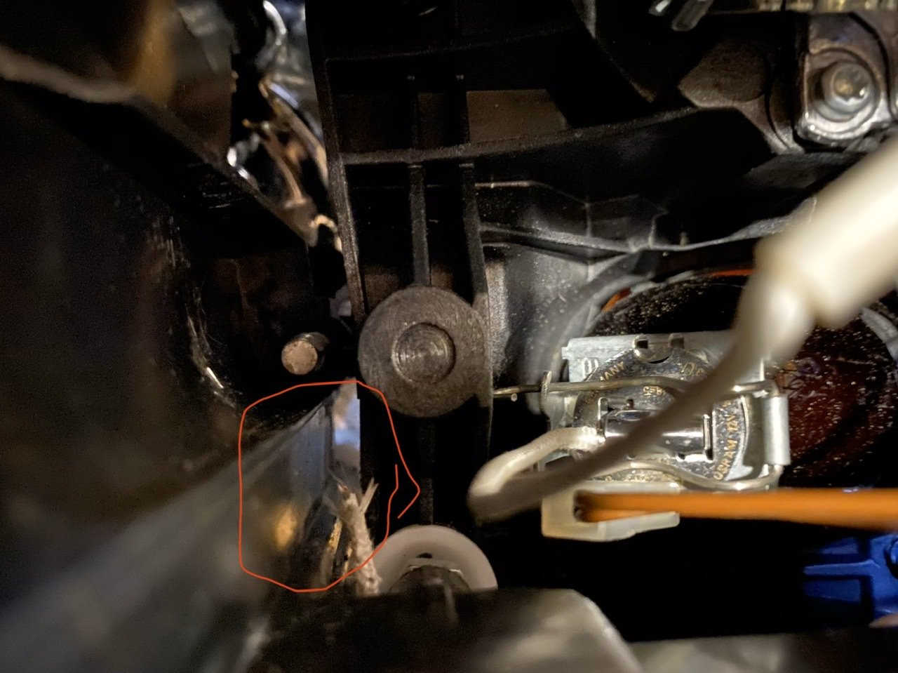

  4. When I start the car I get the headlamp adjustment error, and when I shut the car off the headlights make noise like electric gears having trouble adjusting the headlamps. I have the lights delayed 15 seconds after locking the car. I pulled the headlamps because I needed to replace my cornering bulbs and inspected the wiring inside the housings. Everything looked fine in one housing, and the other looks has a broken wire with white material insulation. 2006 V6 Cayenne Bi-Xenon headlamps Help?
