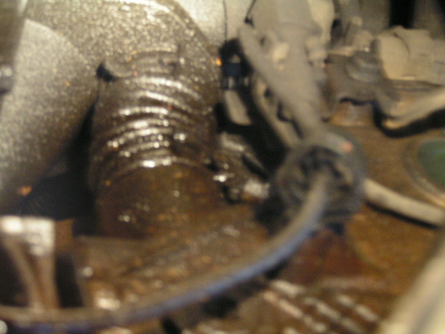

  18. :drive: Can we see a picture of where the leak is? It sounds like a cam cover or exhaust gasket. What timing! I was under my car (also a 99 C2) yesterday for the first time, and found I have this very same leak. (location anyway). Immediately researched the boards, and was led to believe cam cover. If that's the case, is this serious? Can I live with it? How costly is a cam cover repair? I found the leak thanks to a tip from the PCA tech expert, It was coming from a torn bellows hose above the oil separator. I would say it was an easy fix, less than $20 in parts (new hose and screw clamps) no more oil spots on the floor. :cheers:
  19. My 1999 996 C2 coupe 6 speed has an oil leak on the lower drivers side at the lowest point and near the front of the head gasket. the drip is near a small allen bolt just above and about 3" back from the sway bar. Thanks Wiliiam
