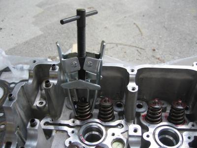

  8. You can tell right away just by touch. It is very loose. In this picture you can see the visual signs. Over time springs can become weak and break. Right now, as I wait out this cold weather, I'm trying to decide if I should go ahead and replace all of them, so there is an equal amount of presure across the board. -k

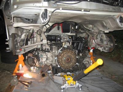

  9. Phillipj, I spent a good month reading and researching. There really wasn’t anything technically difficult, all the fittings came off without resistance and the whole removal was fairly smooth. But no matter how much homework you do, you still have to do some creative problem solving on the fly, like building wood blocks to help secure the transmission, and the occasional surprise Porsche bolt you didn’t expect to find. For instance, as you are removing all the standard bolts for the transmission to engine you’ll come across ONE bolt that is a 10mm triple square and you can’t get a socket in there. Like a small key lock. Evil Germans. Maurice, I did in fact have the TREX board for the tool, but at the last second used another composite board used for lattice. About $6 at your local Home Depot. It was a smoother finish so I wouldn’t run the risk of scratching the Cams. -k
  10. The best oil change EVER! I didn’t like the $3,000 price tag the shop gave me to repair my valve issue, so I decided to tackle it myself. I figured if the engine has to come out, you might as well do some overall maintenance tasks too. And you know the old saying...If you want it done right, you have to do it yourself. It took some time to get my nerve up, and I had to read a lot of posts, and ask a lot of questions (thanks to everyone who participants in these forums) and I'm sure I still have more to learn before I get it back in the car, but for all of you who have ever considered tackling this job, I'll share my opinion that yes, it is possible, and not as challenging as you may think. That being said, if you are shy about changing your oil or brake pads, don’t come down this road yet. I assembled a documentation page www.nutrod.com for all who are interested, and I hope sharing this helps others in their quest for information. As I update it, I will let everyone know here. www.nutrod.com
  11. I have a broken spring on an exhaust valve on cylinder #4. Is it possible to replace the springs yourself without special Porsche tools? Has anyone done this? The engine is out of the car and the head is off. I was planning on taking it to a shop but I come this far, so maybe I can do this too.

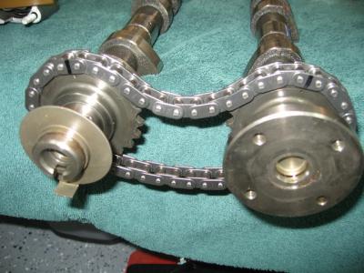

  14. How do plan on setting the timing during reassembly? The manual calls for tool 9612 to attach to the cam, but from what I can tell, it only helps line up the notch in the cam. Something that appears to be completely possible without the tool. I am also struggling to understand the need for tool 9599; the 3 auxiliary chain tensioners. Do the regular tensioner bolts not preform the necessary task? One of the tool sites I saw them on refers to them as "optional" tools rather then "required" Are you using both of these tools?
  15. Does anyone have experience with setting the timing? Manual calls for tool 9612 to attach to the cam, but from what I can tell, it only helps line up the notch in the cam. Something that appears to be completely possible without the tool. I am also struggling to understand the need for tool 9599; the 3 auxiliary chain tensioners. Do the regular tensioner bolts not preform the necessary task? One of the tool sites I saw them on refers to them as "optional" tools rather then "required"

  19. suburban99- Your my new best friend! I discovered my misfire issue was due to 0 compression in #4 cylinder today. I'm guessing I have a bad valve problem and I need to remove the head. So, I too will be dropping my 986 engine this week for Thanksgiving. I also plan to use jack stands in the rear. Too bad, I just replaced the cam solenoid on the other side last month with engine in the car. Would have been much easier now. Did you use 2 jack stands on the rear of the car? How high did you need the clearance to be? Did you remove the bumper and muffler or was the car high enough. I plan to document the process and post for all, but I'm sure I may be asking for some tips and tricks along the way
