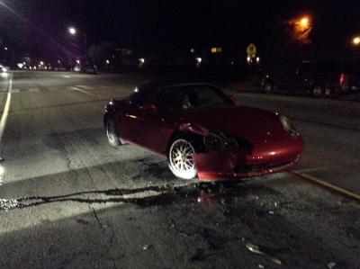

Topic is moot at this point. Someone pulled out out a driveway directly in front of me on a city street tonight (on my way to pick up brake pads!) and we collided. The right front corner is a complete mess, so next week the insurance company will have to determine if it is a total loss. See attached photo. The only body panels damaged are the fender and bumper, but I'm certain the whole right side suspension is toast and there is likely significant structural damage. -
