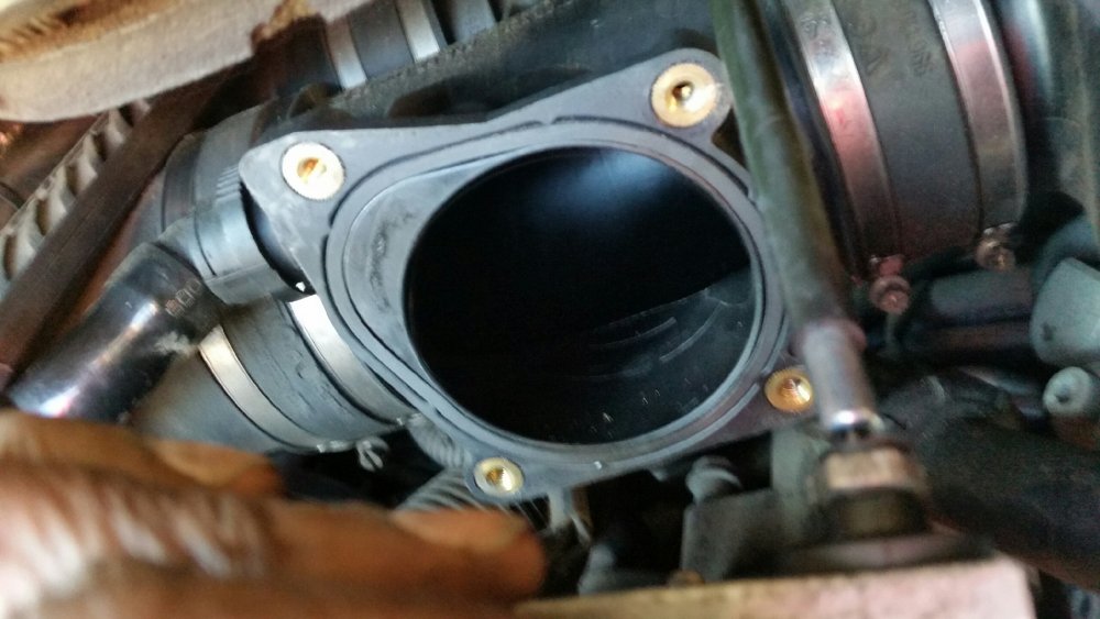

  18. Again, DBJoe thanks for the advice. Advice well given and advice well taken. I've got one more question for you though. In order to maximize the chance of it "holding together. wouldn't I first need to cut off the piece of outer sheath that's still attached to the grommet and then use the epoxy and slide the remaining outer sheath aft of the grommet into the grommet ? I'm convinced that the piece in behind the grommet in the photos is a piece of outer sheath that separated and is still attached to the grommet y'know? After you answer this question, I'm done. I just wanted to know this for "knowledge sake".
  19. Thanks for the response, DBJoe. I had suspected that I may have severed the sheath and I think you have confirmed this. The price of the part is reasonable and I hope that the job isn't too labor intensive. I'm going to call now and get an estimate. When you mention about the McGiver method of using the epoxy, do you mean placing the epoxy on the edge of the outer sheath and let dry and hope it holds until I can make it to my local indy 2 miles away ? I'm definitely purchasing the new throttle cable but I'm wondering if the epoxy would hold long enough to get me to the indy (maybe place a smaller metal band where the two pices join) Whaddaya think ? Thanks again
  20. DB Joe, I have some photos of throttle body I would like you to check out and. I'm more visual than conceptual. When I would push the plastic outer sheathing back into the engine bay, this metallic piece with the cable running through it would appear only to disappear as I would pull the plastic sheathing towards me. Can you tell if I accidently cut the plastic cable piece. The cable sheathing and that piece you see with the nut on it seem to be of the same diameter. Are you saying that I need to take the throttle cable out like I did the first time in order to get it snapped back into place? How can I know if the cable sheathing actually separated. I don't want to have to call a tow truck if this is something elementary that I just am having a problem understanding.
  21. Hey DB Joe, thanks for the advice on this. When I was trying like nobody's business to unclip the cable so that I could back it out of the square hole on the TB housing, I took a pair of pliers to the cable trying to back it out. I hope I didn't let my frustration get the best of me. Like I said before, when I get in the car with the engine not running, It's almost as though I can feel the tension on the cable when I press on the gas pedal. It is not smooth at all and almost feels as though it could snap. This is the same thing you experienced ? Can you be more specific on the outer cable sheath being snapped into the plastic guide? Are you saying the plastic outer sheath needs to be placed over the end of the black plastic piece that protrudes out of the back of the square hole ? I'm trying not to make this more complicated than it needs to be. I have a very short piece of what appears to be outer sheathing attached to the back of the black plastic piece that is not actually attached to the rest of the sheathing. Is there a chance I inadvertently cut this piece?
