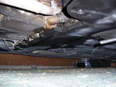

Progress report: Removed access panel, and removed plastic tray after figuring out there was one last middle area bolt...not easy when car is barely jacked a few inches, a few cracked parts, but it will go back on fine. Yes, the plastic tray had a lot of coolant dripping form it, both wet and perhaps dried. From below, the entire area on the bottom and surrounding the water pump has what appears to be coolant spray. The Y hose & screw clamp have drips and remnants of coolant on their underside, but don't seem to be perforated. From above/interior panel, all seems fine, I can see the serpentine belt needs to be removed to remove the water pump. I'm now at the stage where I'm wondering if I should: 1- Run the engine a short while and see of coolant is indeed leaking from below the water pump? or 2- Just remove the water pump and diagnose further. If 2...how do I tell if the water pump is the cause of leakage? Worn gasket? Car is jacked up a few inches, right rear tire, with this in mind, is there a danger with oil flow if I run it for 10 seconds? It appears the water pump can be removed by removing the serpentine belt, and about 5 bolts, asides form making sure I clamp the one hose leading out of it, are there any other hoses or aspects I should be aware of before trying to remove the water pump? I see in the middle photo above that a larger hose and clamp, just below/close to the water pump hose/clamp, have been removed, wonder if I should/need to do this too for convenience/access. Thanks guys, Tony
1998 2.7 with 95k miles As I entered my driveway, I noticed steam type smoke coming out of the rear...then the coolant temp light came on, I immediately drove in the garage and stopped the car. A trail of leaked coolant stretched for about a hundred yards down the street. Coolant continued to leak I guess as steam type smoke, smelled of steaming coolant, came from below the car on the passenger side mostly, and from the side vent. I let the car cool down, it continued to steam a bit out of the side vent mostly, for almost a half hour, as the engine cooled down or leak stopped. I checked the Coolant tank, it's close to empty but still a bit left in the bottom. Note: I replaced the cracked coolant tank myself a year ago, and the cap at the same time. I removed the carpet and the coolant tank is fine, as are the hoses on the tank side. I checked in the engine bay at the rear firewall where the tank comes out, all 3 hoses on that side seem to check ok, and no wetness or leaks there or around those hoses. The coolant seems to have leaked from somewhere near the bottom of the engine, as it was dripping from the plastic protector panel under the engine when I looked. I filled the tank back up, and a bit started dripping again at the bottom of the engine area, but only a few drops. The coolant tank has stayed pretty much full, so I suspect it's the pressure with the engine running that caused leaking wherever the fault is. I did start the engine for a second and turned it off again, it dripped just a bit more from the same area. I do not want to start the engine again unless I get an ok from this board that it's safe, to test. If anyone can help me diagnose the most likely source of leakage, be appreciated. I read over numerous past threads, even one of my own when I replaced my tank, all seem to address tank, or firewall area hoses or the water pump, but not leakage somewhere else. Here is a picture of a hose in the area where dripping seems to be occurring, you can see an orange drop under the shield, perhaps it's leaking either from this hose part, or the metal part to the left of this hose, where this hose connects. On that metal engine part, I did see a few drops on the bottom of that part. I'm trying to upload a few other pics, but having photobucket/slow internet problems. Could it be the water pump? I thought this pump was near the firewall, and the leak "seems" to be from the bottom of the engine, right above where the plastic shield is. There are small weep holes in this shield and the coolant gathered up in this shield and dripped from the weep holes. Lot's of steam came out, so I wonder if it's not more serious then just a hose or the part near the bottom. Car is presently jacked up by the passenger wheel, coolant tank is full, not leaking at the moment, I'm concerned about starting to engine to test, and also assume I should not start the engine with the car jacked up, due to oil flow. Any and all help appreciated, to help diagnose what hose or gasket or part may be the cause, thanks!! Tony
