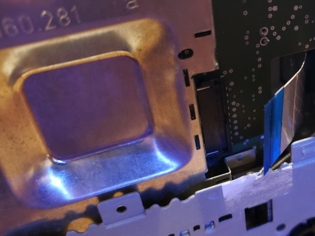

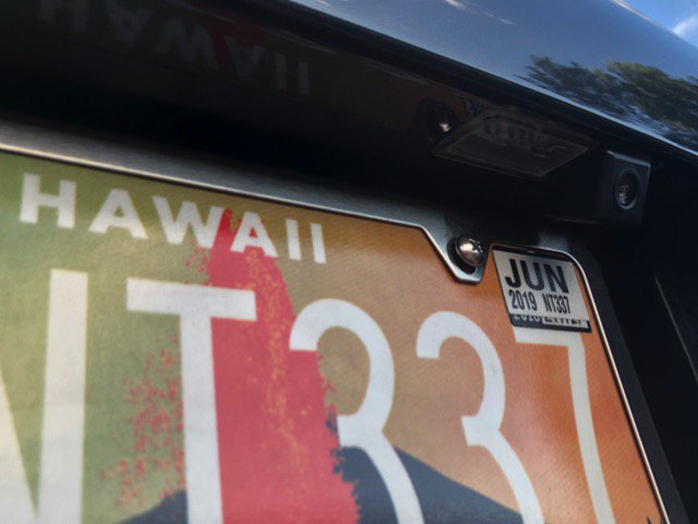

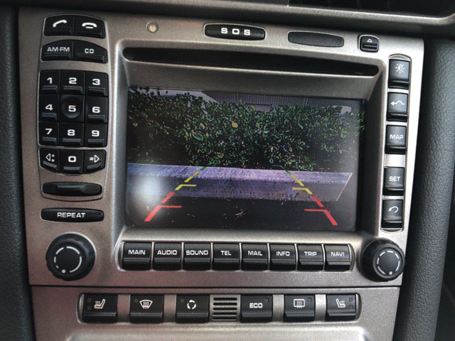

  2. Guys... I have search everywhere and couldn't seem to find anyone that has done this cleanly. But this month I was successful in adding a backup camera to my 2007 997 C2 Cab using this following parts! My goal was to maintain my current PCM 2.1b system, just add reverse camera. (I don't want to add a 3rd party NAV/Audio system. I quite like my BOSE) TVandNav2Go . (This system can push video signal to my factory PCM 2.1b screen when reverse is selected) http://tvandnav2go.com/porsche/43-po...interface.html Camera (Fits cleanly in the reverse light receptacle. https://www.aliexpress.com/item/Car-...001132931.html Many thanks, RP
