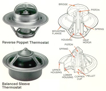

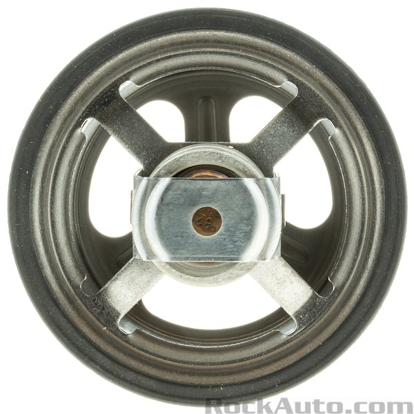

  4. Oh snap! I didn't know the flange separated. I just covered my old thermostat from a recycle bin to verify this functionality. I sort of get it now (I have to think out how this changes things a bit more based on the location of things) So then my question is this: It seems like my thermostat is always opened too much. I just changed the thermostat and it seems the same as before. This morning, my engine never got near it's normal operating temperature - it was cold outside 15-20F. The old one looks just like the new one - closed all the way based on what you just showed me, but the middle copper part seems to be off center with a grinding feeling when I compress the spring. I didn't try compressing the spring on the new. Even when I can get it up to normal temperature, simply putting the interior fan on high drops the engine temperature significantly. What's the problem? Are both the new and the old thermostat bad or is there something missing? Based on the diagram I don't think there are anymore parts involved that might have been missed prior to my ownership. I just picked this car up and I don't' have a maintenance history. Thanks again for your input. That picture was a revelation to me lol
  5. Turbo/Turbo S (maybe even GTS) thermostats are not the typical looking reverse poppet design I've come to know an love (hate?) over the years. The "standard" design is pretty obvious - a hole opens up in the middle against the flow of water. On the Turbo/Turbo S it seems to be a balanced sleeve (am I correct?), which allows pressurized coolant to circulate around all of its moving parts. Sounds great, but I don't understand how it restricts the flow. Upon 1st impression it would seem to me coolant can pass right through it unrestricted, regardless of the position of the internals. I do realize the water pump sits in front of the thermostat and that the inlet(s) coming from the engine and the outlet tubes exit out just over the water pump both are both behind the thermostat. This must have something to do with it but in my mind, having both inlet and the outlet on the other side of the thermostat means the water pump isn't doing anything but churning coolant. See diagram on page 89 of this parts diagram: https://www.porsche.com/all/media/pdf/originalparts/en/E_9PA1_KATALOG.pdf Does somebody know how this all works? Your knowledge is appreciated!
