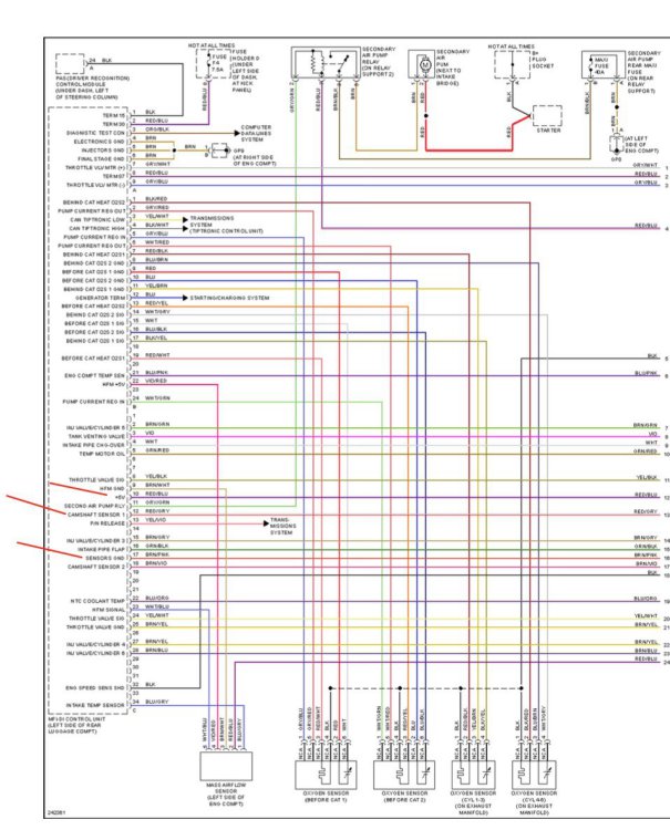

  1. It's a 987.1 05-07 repair manual. Forgot where I got it from. It seems I made a major blunder at diagnosing. Looking at the flow chart more carefully the red/blue originates from fuse box so I'm assuming 12v it then passes thru 8 other sensors ending at mass air flow and cooling water valve on each side. Red/gry goes to DME labeled cam sensor im assuming that's the 5v ref no other sensors and the brwn/pink passes thru 4 sensors and is a shared ground. Again ...order of wires looks reversed at my plug. L to R I have brwn/pink red/gry and red/blu in diagram it's opposite meaning the ground and 12v are reversed. I'll look at the Bank 2 connector see what order it's in. Rechecked voltage 12v red/blu red/gry 55mv (shoud be 5v ref). Brwn/pink gnd. At DME voltage on red/gry is 55mv where it should be 5v ref. This was the same on bank 2 cam sen.ref wire BUT with engine running they are both 7v. Cam 2 ref wire according to flow chart is brwn/vio my wire was brwn(unless vio was no longer visible) This point I'm stumped. DME was rebuilt from Specialized ECU Doctor.Thanks v
  2. OK....Silly question...the diagram circled and posted shows from L to R....Red/Blu Red/Gry Brwn/Pink If I'm looking at my connecter plugged in from L to R its opposite.. I have Brwn/Pink Red/Gry Red/Blu. It is a used a car and evidence of peeps being in there already....I think.
  3. My diagrams different unless I'm not understanding correctly. Ill post the one im looking at.Im troubleshooting wires #10 #12 and #17 from DME. I am seeing a fluctuating 5-8v on pin 12 with engine running. I see 12v on same pin with only key energized. Im backprobing + wire on multimeter to whatever pin on sensor plug im testing at the time(pin 10 or 12) and (-) going to common ground on engine block. I might add I saw 12v STILL on pin10 red/blue with the plug unplugged at the DME with key energized ..this led me to believe the power was coming from a different source other than DME(It was unplugged) Maybe I'm on a completely incorrect diagram?
  4. Im back!! So I figured let me go backwards one step at a time. I left the red/gry splice in and returned the red/blu back using original loom wire. Car started and ran no problem with exception of the same CEL p0010 triggered almost immediately. Cleared it and now getting pending p0010. Tested voltage: Ignition on. Red/blu 12v Red/gry 12v Engine Running. Red/blu 12v Red/gry 5-8v(fluctuating) Totally boggled,does this mean red/gry is the signal wire being the voltage is changed when running( from 12v to 5v)? Diagram shows red/blu at 5v. Brn/pink is ground. What next ?

  6. Hey John...thanks for getting back. Im sure about tracing wires to the harness pins 10 and 12 for the wires i spliced. Correct volages at cam sensor plug. I don't know if they pass thru another device ...from the looks of the diagram it dosent look like they do. Wires are still there i can revert if I have to.
  7. Ok now I went into PANICK MODE. I did what I said what I was going to do...essentially replaced the red/blu 5v wire between the DME and cam pos.sensor plug and FAILURE car dosent start. Tested voltage to red/gry wire and got nothing ...supposed to be 12v. Figured I disturbed an already failing wire...replaced wire between DME and plug and now have my 12v on red/gry 5v on red/blu and ground on brwn/Pink wire (ignition on) and...FAILURE. Car cranks begins to turn over briefly but won't start. What the hell did i do. Checked all fuses in foot well the stereo fuse was blown somehow. Other than that they were all good. Please help. Thanks V PS getting pending p0638,p2122,p2127 CELs. Throttle sensor
  8. Ok well here's what I found: Wire. Continuity. Resis. Vol.Drop Red/Blu. No. Open. 7.4v Red/Gry Yes. .3k. None Brwn/Pink. Yes. .2k. None Volts at DME and Sen.Plug Ignition ON DME. PLUG Red/Blu. 5v. 12.6v Red/Gry. 12.8. 12.2v Brwn/Pink. .9mv. 1.2mv I guess the oddest is the red/blu with no continuity but voltage when energized. Maybe it goes to a relay? Let me know what everyone thinks. Bad harness or the DME goes back to Specialized ECU. Thanks V Did some reading seems to me red/blu has a short to voltage cause that wire supposed to stay at 5v. So maybe try replacing the red/Blu wire from DME to plug. Correct?

  10. Well wait a minute. If I measure what I'm getting out of the back of the connector at the DME(back test it) and it matches what I'm getting at the sensor connector then I know it's not the harness....correct? V

  13. Thanks, Well the new sensor didn't change anything, threw a CEL after 145 miles. So guess it wasn't the sensor. I probed around w my new probe/tracer. Findings with engine running: 14v R/Bl right connector 12v R/Gy center " Gnd Brn/Pink left " Traced positive for all 3 wires from Connector to DME in the trunk(got a trace tone) Positive continuity for all EXCEPT the R/Blu right wire. No continuity but there was a tone when traced. Don't get it. Any thoughts? Put everything back together and CEL disappeared. Thanks V
