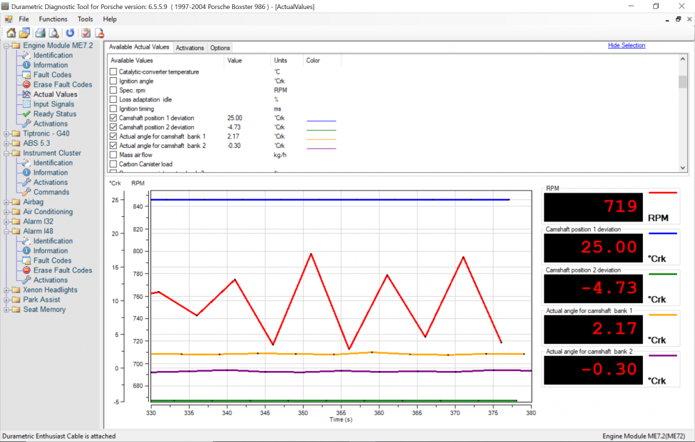

  8. including an export from Durametic. Captured a bunch of fields. Reason I think this is a wiring issue is that if you look at the oil temp it swings very wild and I believe that the wiring for the cam sensor and oil temp sensor are right by each other. 2018_12_19_17_50_01.csv

  11. Got my durametric today. Having problems with it though. every time I go to activate cam 1 adjustment it stops communicating. Was able to get the cam & deviations though. 2018_12_18_17_03_10.xls 2018_12_18_17_12_02.xls
  12. Am I reading the fuel trims correct though? Bank one seems ok but bank 2 is running rich isn't it? The codes are all for bank one. I thought anything less the 5% was normal for long term. Cam deviation is the first thing in the list Wednesday when it arrives. Car had been running great then strmarted to through temhe misfire codes. I have a new cam sensor but haven't installed that yet, waiting to see what the timing is first. Car now has 106k miles on it. Bought it 2 years ago needing a coolant hose replaced for a steal. Needs a paint job bad and new seat covers, but I have a set of gt3 seats coming in that I will recover then next summer it's off to get a new paintjob. Since I have had it I have done all brake pads and rotors and normal oil changes. Had been running great the past 2 years.
