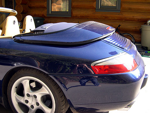

  8. Well I figured it out (dealer couldn't get me in until next Monday). The flap on the driver's side was getting caught on a thick black wire. I just shoved the wire towards the center out of the way and Violà. :)

  10. Yup, it's the flap on the driver's side. It won't go into the top open position fully, even when I try "helping" it. :censored:
  11. Thanks LV - D*mn, the service dept. isn't open until Monday :(
  12. I just took the hardtop off (it's going to be in the 70s here today and tomorrow) and the soft top won't open all the way. The top itself goes down, but the body portion won't lower all the way (see pic). Any ideas? I know it's dirty and I'm in my PJs. :P
