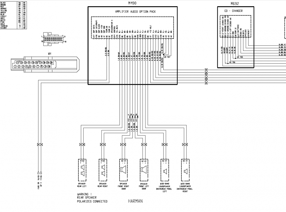

  6. Thanks, Kevin. The previous owner had installed a set of full-range speakers in the doors as well as replacements in the dash. The door speakers are barely audible. Since the Haes amplifier is supposed to have four-channels, I was hoping to find the "second" set of channels (rear, left and right shown on some wiring diagrams for an M490 system) to bring the door speakers up as a fully-functional rear channel. I have since learned that the "second" set of two channels on this amp are the low pass filtered circuits to the door speakers. These circuits do not respond to the fader function, so are therefore not part of a secondary channel in the typical sense. Attached is the M490 system diagram showing the additional rear channels. Although the actual amp is not identified, my pin configuration is identical. If there is output at pins B16, B6, B15, B5, then I might have the rear channel. More testing is in the works. If there's nothing there, your suggestion of a new amplifier is probably the way to go. Thanks again.
  7. Searched but could not find definitive discussion of this amplifier's functions. My 2001 with M490 (dash and door speakers, no rear speakers) has the "four-channel" Haes amp, but the stock setup has no controllable "rear" channel. All speakers currently operate on the "front" setting only. What (if any) function is active on the second (rear?) channel for this amp (and which pin numbers identify this channel?) I understand that the door speakers are fed only low frequency signals from the amp, but are they on the second "channel" - not controlled separately from the head unit? Are there any unused output pins from this amplifier that may be used to drive the door speakers independently of the filtered signal now being supplied by the amp's current wiring? Several wiring diagrams suggest that a second (rear) channel may be available from the amp to drive any additional rear speakers, or a set of full-range door speakers. Any help is most appreciated.
