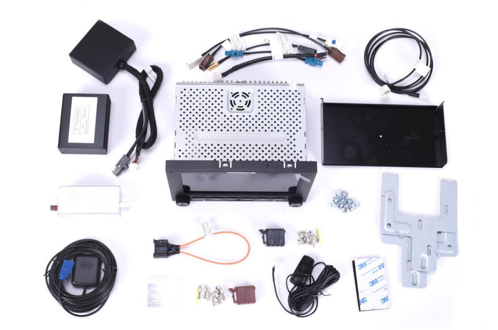

  10. Hi all, I purchased and installed the new PCCM+ for the 996TT (P/N 996 642 59000). After some issues with the sound, Porsche realised that they also needed to install a control unit (P/N 996 642 58000 - cost is about $140). Initially I did not second guessed it but then I saw the photo below which states that it is in the original package (it the second box from top left side). Can any of you confirm that this control unit is installed? Especially for my European readers. Brgds

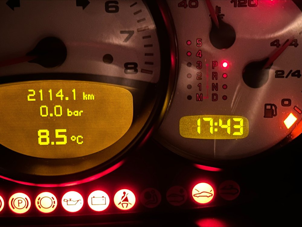

  11. If you pay attention to the photo I post below: 1 is the airbag (this one comes on and off right away - should be good I assume!), 2 is for the rear spoiler? It never comes on but I know the spoiler works great and 3 is for the cab (don’t have cab so should be OK to be off) your photo maybe is from an older 996? mine is 2003 996TT
  12. Hi all, This is what my instrument cluster looks like when i insert the key and switch it on (engine off). All the lights except the two shown (air bag and rear wing) are on. Is this normal?
