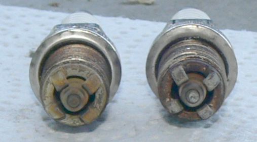

  14. Update on misfire cylinder #1: About a month ago, I removed coil pack #1 and #3 for examination. They both looked fine, so I swapped them around, put original #3 into #1 and vice versa. Nothing changed in the misfire status. I'm still getting bad misfiring on cold starts after the car sits for a few hours. Rough idle lasts for about 30 seconds then it is smooth again. Durametric confirms that cylinder #1 is still the one that's misfiring. So today I finally have time and pulled a couple of plugs to have a look today. I removed them after the car sat for 24 hours. The attached photos show plug from cyl #3 on the left and #1 on the right. I don't know what to make of these so I'm hoping for some opinion from those familiar with diagnosis by looking at these plugs. I should also say, I have been loosing coolant mysteriously so I'm hoping it isn't a blown head gasket or a crack. I've got the new updated coolant cap, and I don't see any fluid in the trunk floor or behind the passenger seat under the carpets. I do smell coolant during start ups. I don't see any steam or dripping under the engine area. I would say I've lost 2 litres of coolant in the last 2 months, maybe 5000 km of driving. Suggestions? Derek
