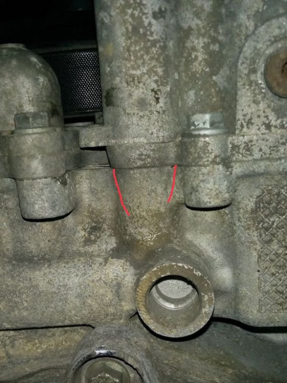

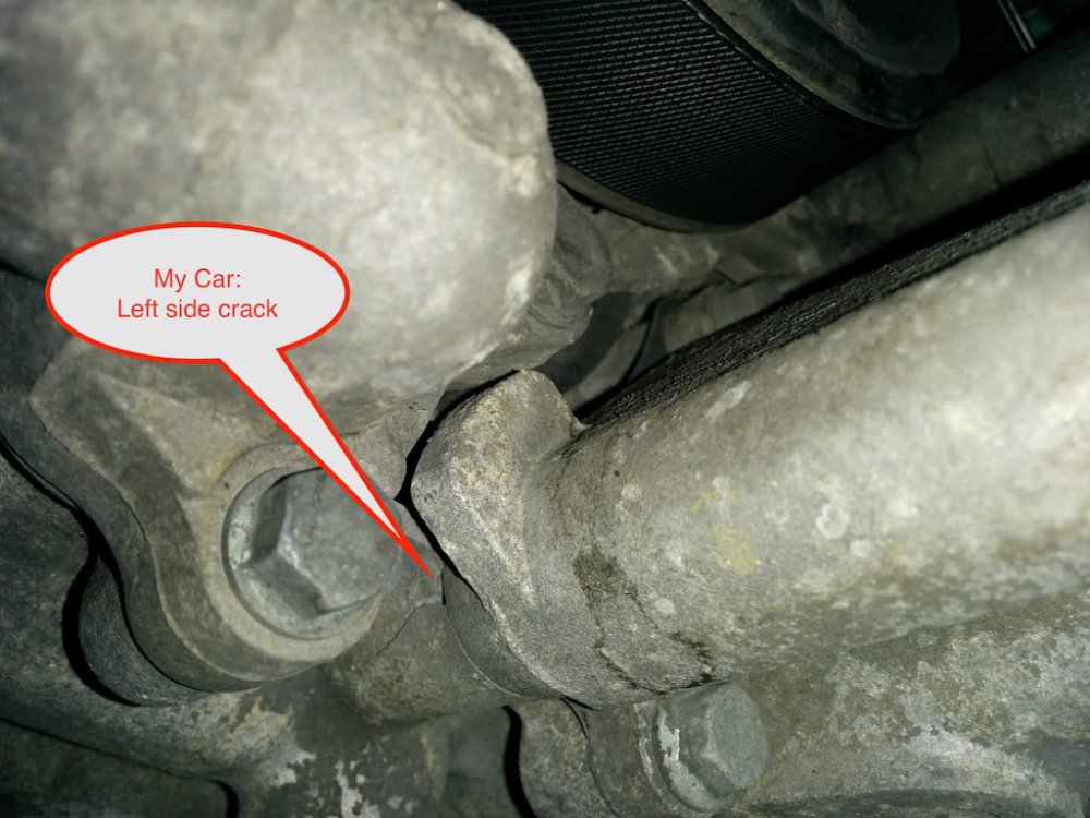

  4. Would be great to get some more input from forum members on this issue. Keep driving the car or do I tear the engine down to fix the crack / replace the case half? Sent from my iPad using Tapatalk
  5. Thanks. Will keep in mind. Sent from my Nexus 5 using Tapatalk
