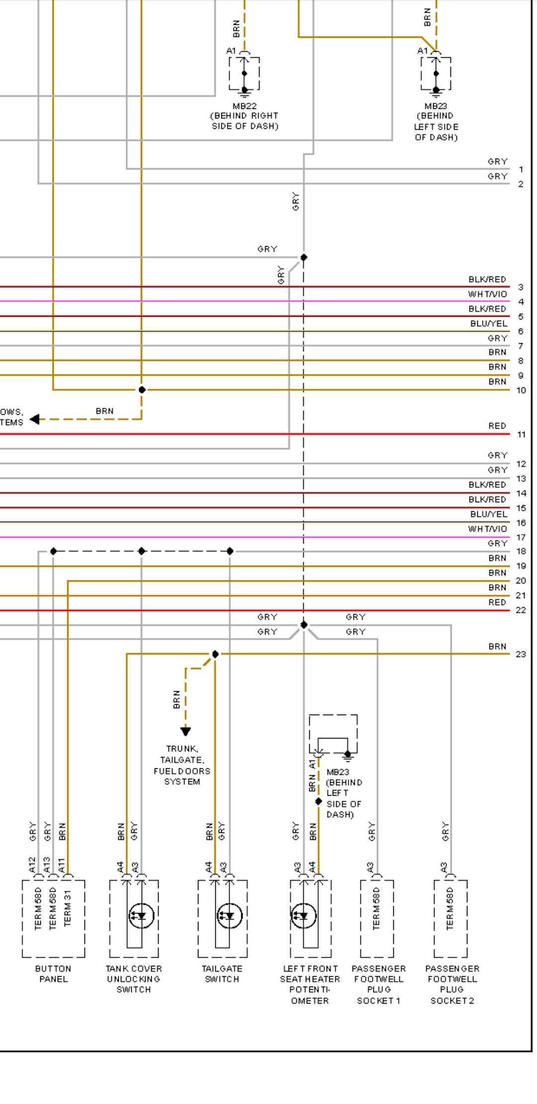

  13. Hi @Loren, no not as yet. I assumed this was a simple wiring/grounding issue given the following conditions are true: 1) the rear tailgate switch appears to be working fine 2) the fuel cap release switch from the drivers door is working fine which is also routed into the drivers control unit 3) there is voltage on the pins foing into the tailgate release switch 4) the switch itself is ok Right now, I have 3 unresolved issues: 1) starter motor is sluggish and never starts on first turn. Always takes at least 2 turns to fire up 2) rear tailgate release button on the drivers door and remote keyfob are not working (although with a long keypress on the keyfob, the rear tailgate glass panel does release). 3) the alarm doesn't sound, only the hazard lights illuminate Would a PIWIS or Durametric scan assist with these issues? Please note that I managed to clear up 1 issue with some cleaning of the ground points which was the original issue I had with the central locking not locking the tailgate, this now appears to work correctly.
  14. Thank you @Rick150. Is there a diagram similar to the one I posted above that shows the "tailgate switch" and the "tank cover unlocking switch" which routes into the "driver door control unit". I am only interested in this now as those controls are on the drivers door and that is where the problem is
  15. Hi @Rick150, no need to check the fuse as the tailgate opens and closes perfectly when I use the handle at the rear. Please can you kindly send me all the wiring diagrams for the interior lights circuits as that is where the switch for the tailgate release is located. I have this diagram but it makes no sense to me as both the fuel flap and tailgate lid switches are connected to the same wires. Can you explain it at all as I am baffled by it. Also I have 4 wires going into my tailgate switch, not 2. The other 2 are VIO/WHI and Brown which are not shown here....this is a complete mystery to me
