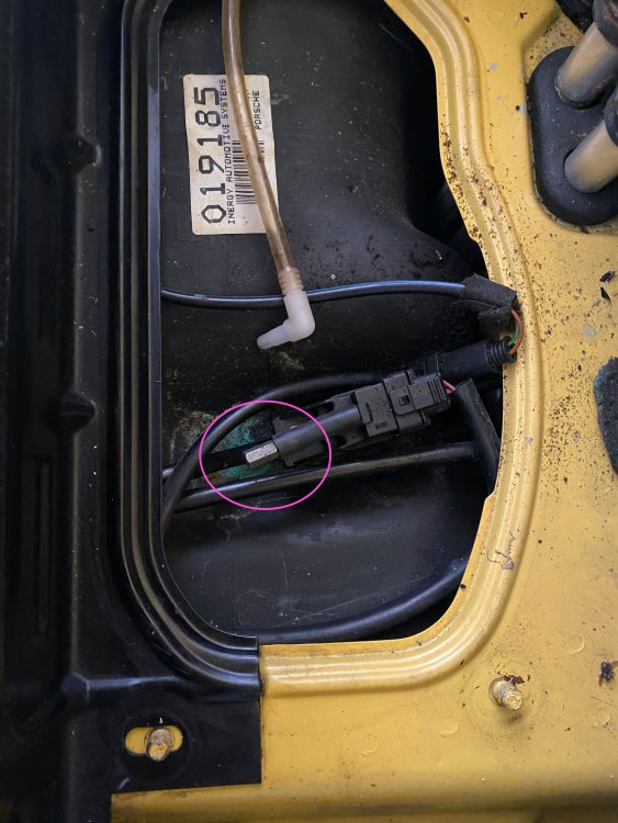

  1. Loren, thanks for your input, however the white plastic 90 at the top of the pic is the battery vent line. The fitting inside the circle is my concern... It's a barb fitting and PET shows item 21 is a hose clamp. That would mean I'm missing a hose. The PET diagram doesn't show a hose coming off or going to that electrical valve, but shows a hose clamp. Someone out there must have some experience with this... a pic of what yours looks like if anyone has taken a pic of the top of the gas tank... Today when I went into the garage the stink was down to a faint smell, but you just can't plug up a hose which might have some other consequences..
  2. 2003 996 C4S I'm still chasing the big stink... Does anyone know what the plastic 1/8" barb fitting is for? Should there be a hose connected to it? If you're lookin gm at the PET my gas tank is a saddle bag configuration which is different different than the standard body. PET shows a hose clamp next to the barb valve, I'd sure be grateful if anyone could tell me if I'm missing a hose and clamp. OH, I inserted a plug just to see if the gas fumes would go away, they didn't... However that's with just 1 day on the clock.

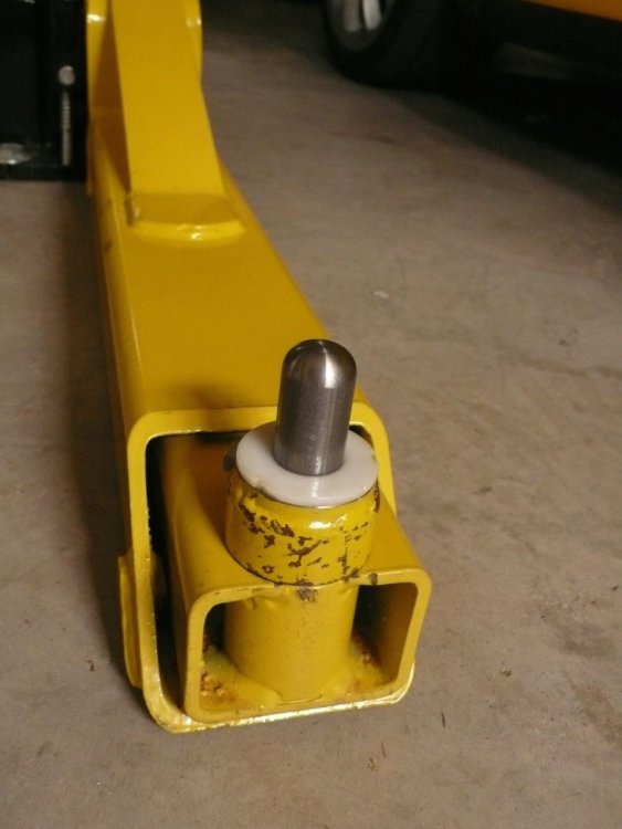

  9. Bill, One more thing, I did this so many years ago I can't remember what we did. I believe we took one of the stock lifting devices and machine these spring loaded pins. The best thing is you know the car is engaged with the lifting arms.
