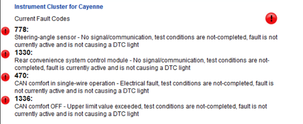

  4. Has anybody figured this out yet?? I was sitting in mine with key off and all of a sudden there was a loud horn (different sound from regular horn) I started the car and the horn shut off within 100yrds. I drive home and turned key off to find all rear lights on, rear wiper on, and neither tailgate nor hatch will close. Latch is stuck in open position on both!! I'm thinking rear comfort module but I'm not really sure
  5. Has anybody figured this out??? I'm sure hoping Timothy can help a lady out that's having same problems 5 years later! I can drive but brake lights are constant on so no perception of me using brakes plus the fact that the glass hatch nor the tailgate will even latch so they could just be floppin;! It started I was sitting in my car key in ignition but not on finishing up some work on my phone waiting for the rain to die down a little when all of a sudden there is a blaring solid horn sound ( doesn't sound like anything I've ever made happen) and that last for about 3-5 minutes then stops. I turned the car on drove a bit before it stopped but it didn't immobolize so I then got out of car and went inside until my neighbors informed me that my lights were on and boy were they on the whole rear end! HHHEEEELLLLPPPPPP Am I chasing a wire or the rear BCM? Or something else??
