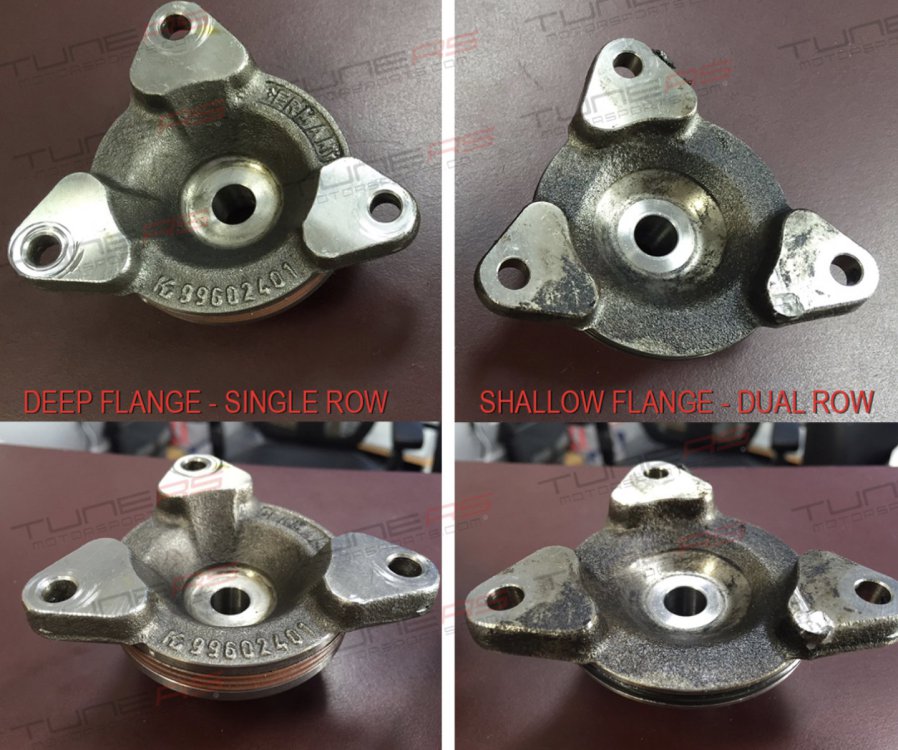

  2. Ahh…thank you. I see the flange depth as the give away and also found this better image too.
  3. Been out of the P-World for some time and we are thinking of picking up another 986/7. When doing my research on the over discussed IMS discussion there is only one piece of info I'm not seeing in the 101 articles and videos I've watched. Can one tell the double vs. single (say on a 2000 base) from looking at the cover on the IMS when the flywheel is off...or does the IMS 3 bolt cover need removed for proper identification? A bit confused on how to tell w/o going full into pulling git out. Thx.
