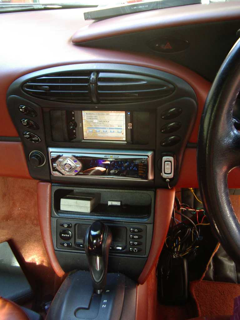

  22. Thanks for the tips guys. The trays came out quite easily once I knew there's nothing holding them back. The install is almost finished. Here's a pic.
  23. Thanks TP. I pulled with more confidence and out it came just like that. The whole PPC install is almost complete after 1 day.
  24. I am currently in the process of installing a PPC into my Boxster. So the AC needs to be relocated to where the lower storage tray is. I don't seem to be able to pull out the trays easily despite warping the plastic quite extensively as I pulled. Is there anything holding them/it in beside clips? What's the trick to getting the tray out?
