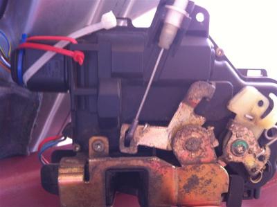

My post does refer to a third "failure point" inside the door lock mechanism itself. I am just not sure if there is actually a physical microswitch inside the DLM. It's certainly a "microswitch by principle". The DLM would sense if the door is open - by the way of the switching plate's position - one can simulate a door closed position by manually flicking that switch plate in the exposed part of the DLM when the door open. I am just not sure if the flick of that plate actually actuates a microswitch. It's probably a direct switching effect. But the result is the same. And the DLM is difficult to service. If the DLM is responsible, the failure point is usually not at this "microswitch by principle" but rather at where the harness connects. Anyway, I just noticed that I was one of the original posters of this thread, back in 2004. And I just fixed this problem I posted about then, a few weeks ago. It took me 6 years to get to it! Haha....... :)
The Bowden (or is it Bowen?) cable is a purchasable item. There was one for sale on eBay not long ago. There are two microswitches - one on the inner door handle, one on the external door handle. Maurice's picture actually also shows where the external handle microswitch is attached. The internal microswitch position would be very obvious once you open the panel. Either of these could be faulty/loose. Just disconnect one and then the other (or both) to diagnose your problem. Another failure point is the connector at the door lock mechanism - wiggle it at the connector and see if you can reproduce the problem. This won't be too hard at all.

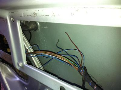

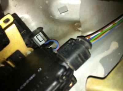

Pic of the wire harness that goes to the DLM - the dangling wires eventually pull the pins that supply that connector loose (the pins get pulled off the solder points on the circuit board); you can test yours by giving the connector a little wiggle - if the wiggling causes your window to drop down and go up, then one/some of your pins on the circuit board are de-soldered (likely) or the connector is loose (unlikely). Second pic and the temporary cable tie solution that holds the hold complex in a tight non-mobile position to try to force the pins (which can't be see unless you open the door lock assembly itself) to contact the circuit board. This solution didn't last long. Re-soldering was the only way (holding up thus far).
