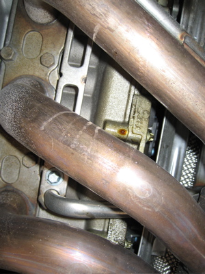

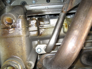

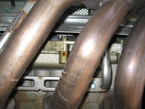

  2. I think it is the VarioCam kicking in at 3200 rpms.

  4. UPDATE: Took it to the dealer, they indicated that the cam cover wasn't properly tightened. Resealed it and it shouldn't leak. Hopefully, this is it. On another note, while it was at the dealer, I had them throw on the PSE without the switch (always on) and love it. Can't imagine having a 911 without it now. Well worth the $. Dealer experience was very good too.
  5. Thanks! I sent the pics to the dealer and they think it might be the cosmoline or a small leak from the cam cover or spark plug area. I am bringing it in later this week.
