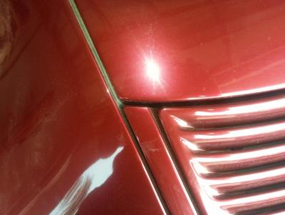

  2. I took off the strut and when I open the engine lid is like the strut has never been there, it opens to the same mini gap. Think is the strut. Will replace it.

  7. 996, MY99, manual, C2, Coupe, manual hood/trunk release. How big is the gap between the tuck lid and body when you first open the engine lid? In mine there is hardly room to insert the fingers. Is that normal or the shock needs replacement? The pic shows the gap after pulling the engine lever. Thanks.
