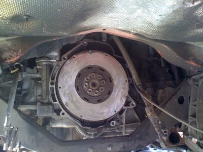

  3. I just changed my clutch and was dreading that I had damaged the flywheel and would have to replace it. . . Luckily, It wasn't that bad at all!!! I ended up using a die grinder with a 50 or 80 grit surface prep disc from northern tool. Took about twenty minutes and I was quite happy with the results. Some pics for your viewing pleasure. Regards, JP Hooie :renntech:
