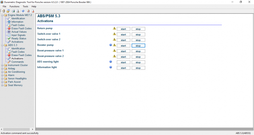

  5. That is for a 987. Mine is a 986 & the Durametric Graphic is on my August 17 post. I'm just trying to find the proceedure that goes with it.
  6. When I replaced the brake booster I'm pretty sure significant air got into the ABS system. D
  7. Have now purchased Durametric Enthusiast Version & am seeking the procedure to bleed the barkes. Is anyone able to assist? I know the oredr of the wheels to do what I need is which function of the ABS 5.3 on Durametric to activate & when. Any assistance would be greatly appreciated.

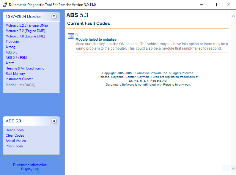

  8. I replaced the brake booster & need to activate the ABS control newtork in order to bleed the barkes. The Duramatric I have says 'Moduled failed to initialise' for most options selected. Any idea's?
