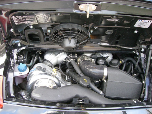

  1. Thanks Loren. Is there a specific type of testing equipment I should ask for to pinpoint the problem, or is it going to take some time. Also how about the P1165 Engine compartment purge fan that gave me a "bad engine compartment blower fan" error. I opened the engine lid and the fan does not even turn on. I heard there was a recall on the 997 fan motor. Do you know anything about that? Thanks again

  7. OK does anyone have the location and possibly pics of the MAF location in a 997S?
