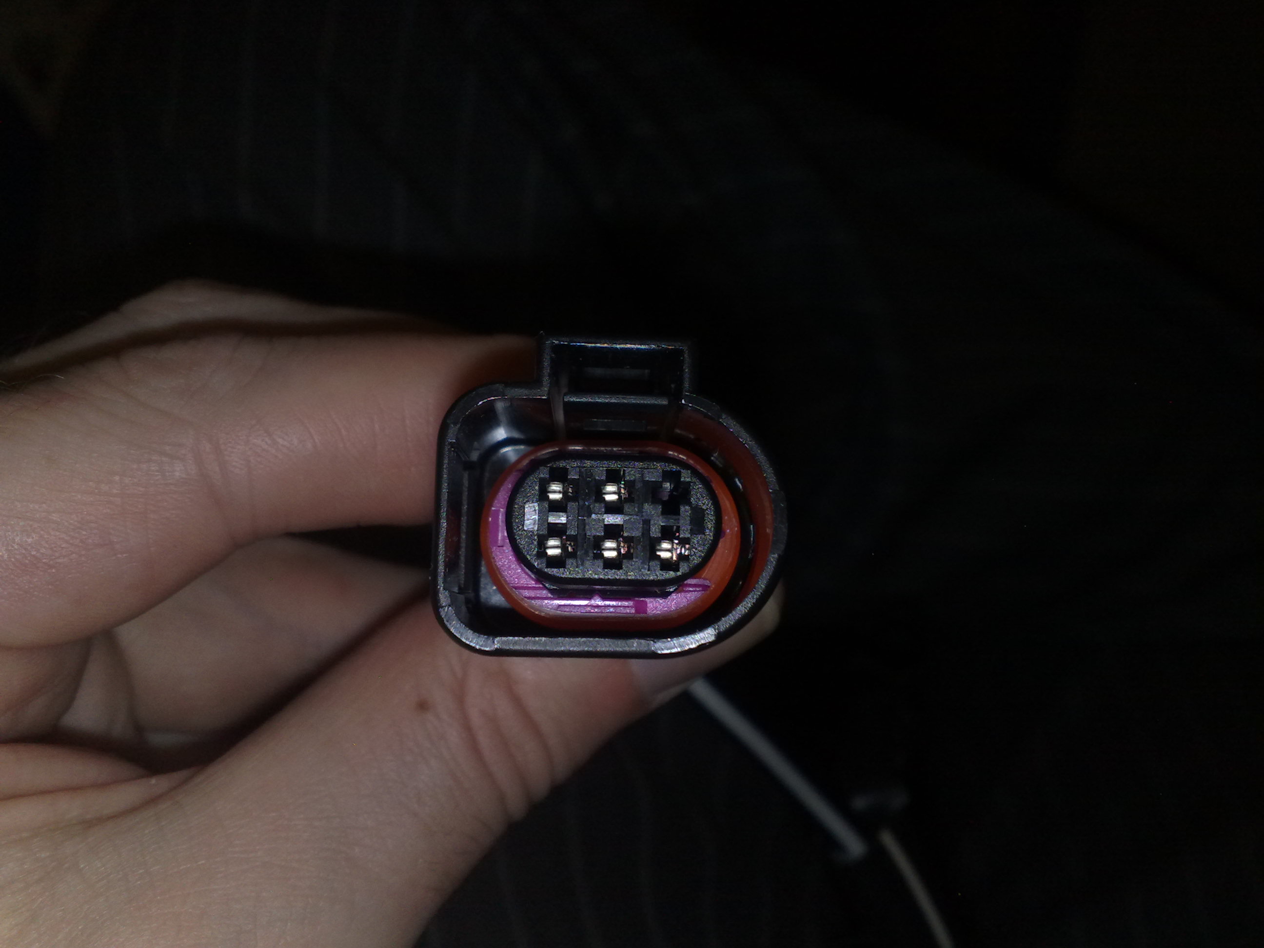

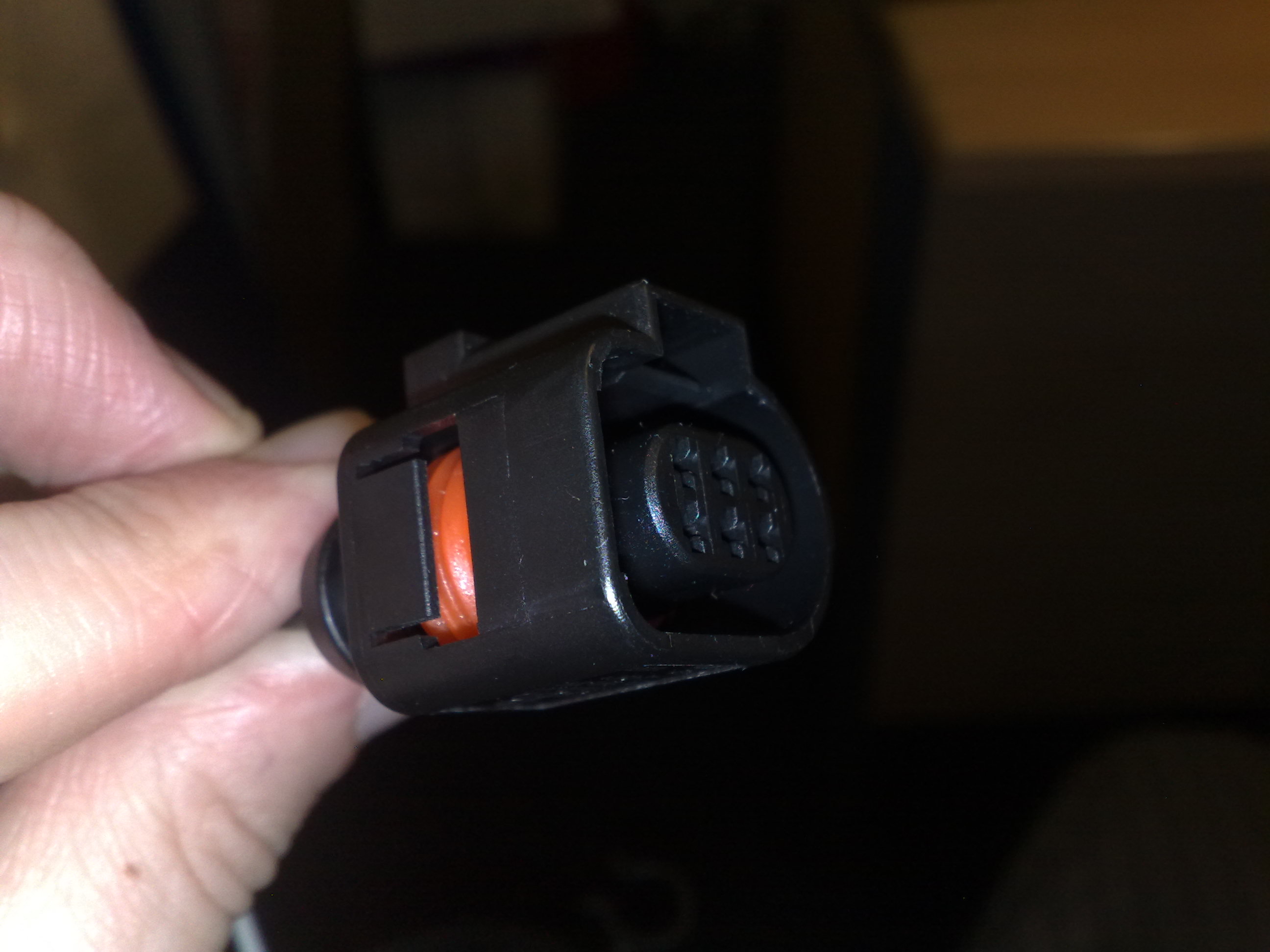

  7. :help: i wonder if you can help me, i am in the process of collecting the parts to convert my 997 c4 cab to turbo front (with led indicators). i now have all the parts i need , so i thought. i purchased a front turbo loom (front bumper loom) hoping i could just plug and play however there are no plugs for the 2 led control units ( 997.618 201 00). opc told me that they plug in to the other loom in the trunk or will need to be hacked in, have you any idea where i need to hack, and also where i might be able to get hold of a couple of plugs to plug and play, they have a vw audi part number 1J0 973 713, (have attached jpegs) and plug in to the led control units, have searched the site but amazingly cant find any threads ref this mod, someone somewhere must have done it, :help: Tim Holmes
  8. i wonder if you can help me, i am in the process of collecting the parts to convert my 997 c4 cab to turbo front (with led indicators). i now have all the parts i need , so i thought. i purchased a front turbo loom (front bumper loom) hoping i could just plug and play however there are no plugs for the 2 led control units ( 997.618 201 00). opc told me that they plug in to the other loom in the trunk or will need to be hacked in, have you any idea where i need to hack, and also where i might be able to get hold of a couple of plugs to plug and play, they have a vw audi part number 1J0 973 713, (have attached jpegs) and plug in to the led control units, have searched the site but amazingly cant find any threads ref this mod, someone somewhere must have done it, :help: Tim Holmes
  9. :help: i wonder if you can help me, i am in the process of collecting the parts to convert my 997 c4 cab to turbo front (with led indicators). i now have all the parts i need , so i thought. i purchased a front turbo loom (front bumper loom) hoping i could just plug and play however there are no plugs for the 2 led control units ( 997.618 201 00). opc told me that they plug in to the other loom in the trunk or will need to be hacked in, have you any idea where i need to hack, and also where i might be able to get hold of a couple of plugs to plug and play, have searched the site but amazingly cant find any threads ref this mod, Best Regards Tim Holmes
