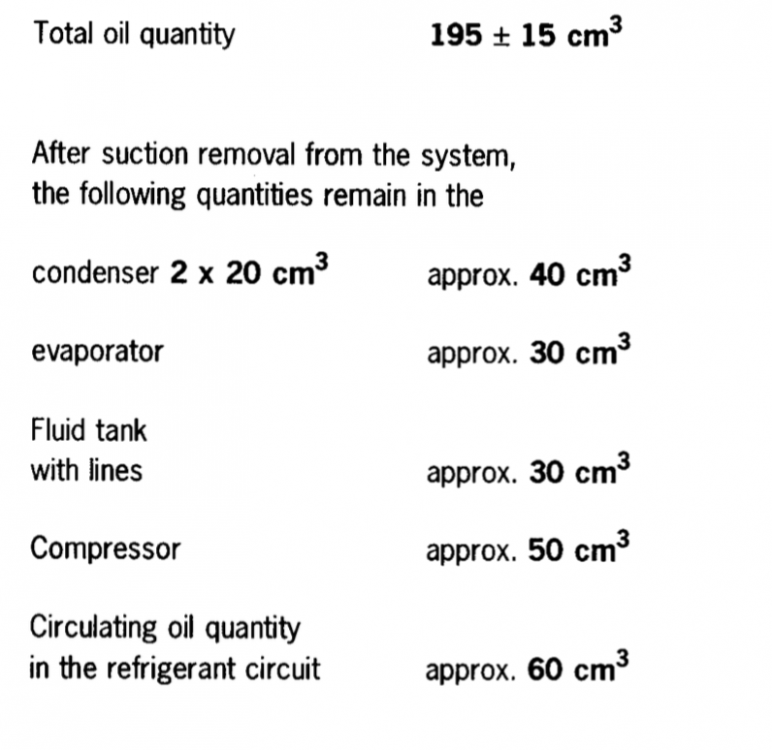

  7. Thanks for the reply, Joe! As I understand the manual most of the oil remains in the system. Isn´t it too much, if I just fill up another 195g? What could happen, if I fill too much oil?
  8. Hi, both of my condensers were leaking, so I had replaced them. The system was already completely empty. A workshop refilled the system with 900g R-134a and only 5g oil. I doubt, that they have filled up enough oil. As per manual the total qty. is about 195g and about 20g remain in a single condenser. So for my understanding at least 2x20g of oil should be added for the replaced condensers and an amount for the oil that escaped together with the refrigerant. Am I wrong or what is the best procedure to determine the correct amount of oil. I think adding too much is also not a good idea? Thanks for any help!!!

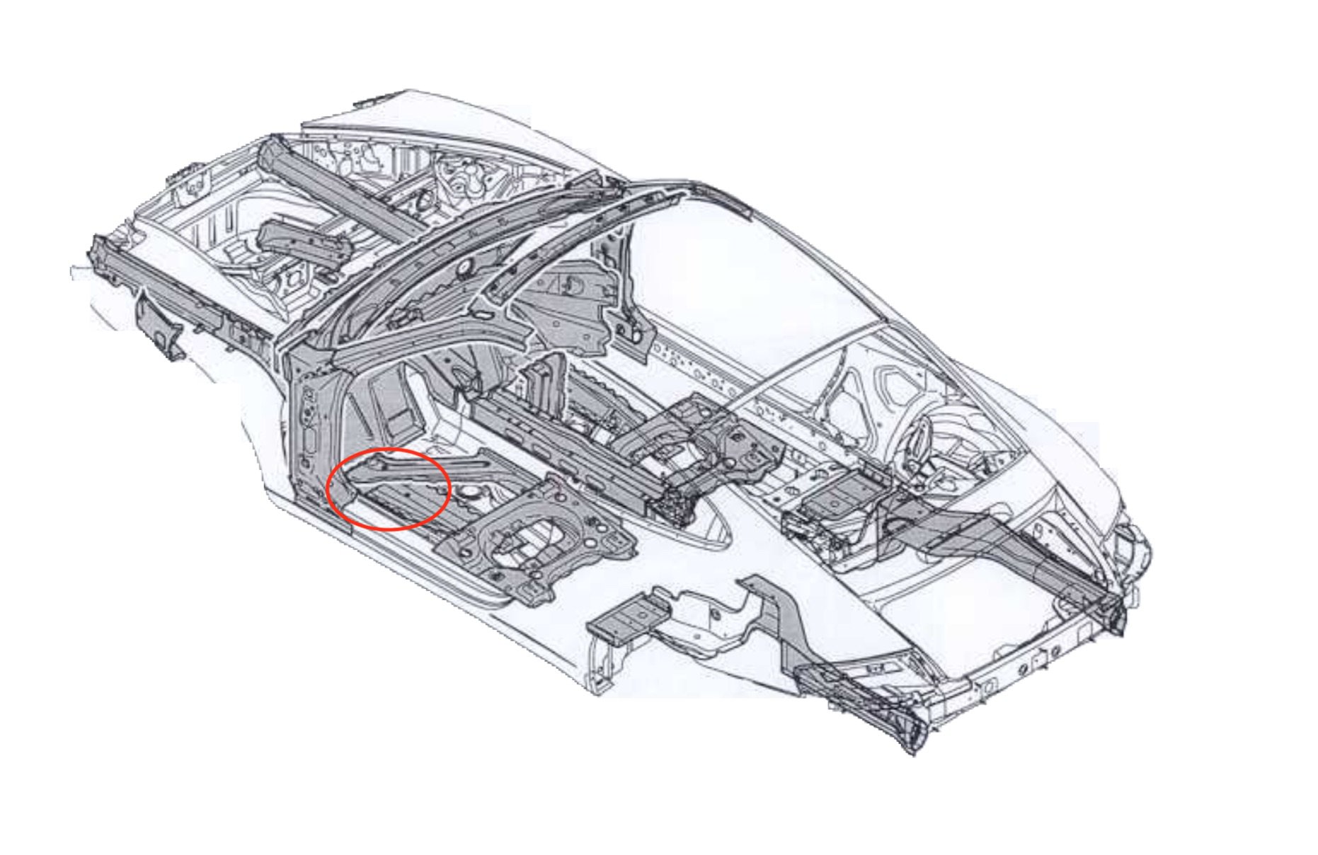

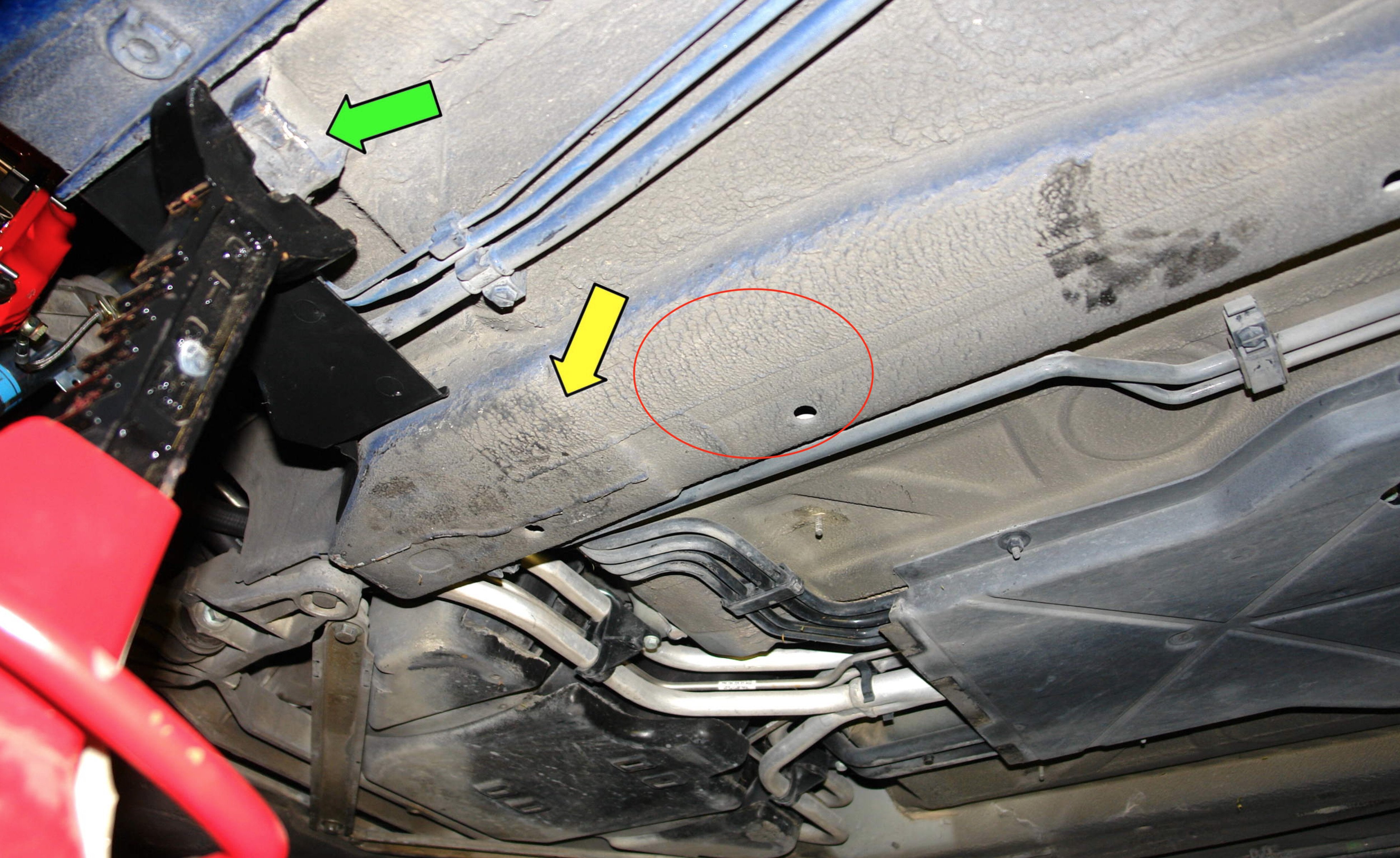

  13. "Blind" was more a figure, of course, you need feeling for that. Coolant lines are much more to the middle of the car. Advantage of my described method is, that you can put both jack stands under the factory points at the same time with only one lift! The car stands stable like a rock. Doesn´t matter if use the yellow or red marked point, but the red would make it easier?
  14. Thanks again. The liftbars are interesting when lifting the entire vehicle. However, for a quick lift at the front not convenient. Actually the point marked with the yellow arrow ist strong enough and works very good. You only have to watch that the jack is not in the way to put the jack stand under the factory point. This can be done when you use the jack a bit "diagonal". If the red circled point would be usable, you could put the jack more or less "blind" and straight under the car.I am not sure, but as per manual this should be also a carrying part made of high strenght steel.
  15. Thanks for your reply! When lifting at the rear jacking point, the car (front and rear) comes up only on one side. With the jacking point in the pic both the left and right front side come up together, which is much more comfortable. However the point in question (red circle) would make it again easier, since you do not block the way for the jack stand. Therefore my question, if it is safe.
  16. Hi, I have placed the jack many times at the area marked with the yellow arrow as per Pelican parts proposal. My problem is, that it is alway tricky to put a jack stand under the factory lifting points (green arrow) at the same time, since the jack is still in the way! It would be much easier for me to lift more behind (e.g. red circle), but I am not sure, if this is strong enough (high strength steel?). Has somebody tried to lift there? I am a afraid to damage the under car. Thanks a lot!
